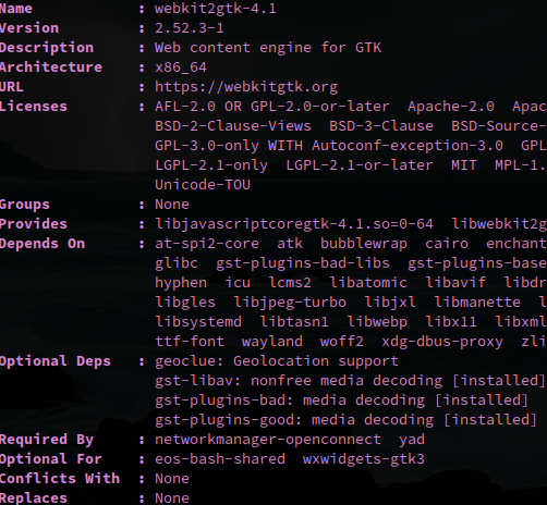

You can check what is depending on webkit2gtk:
pacman -Qi webkit2gtk
Required By // Optional For will show it.
I would recommend to remove these together with webkit2gtk if you do not need them. If you need, check if there is a better version depending on the version from extra instead,

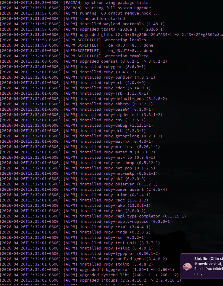

Is what not installed? dfldp is installed so is webkit2gtk-4.1 and webkit2gtk so I don’t understand your question. Also still confused how updating my system made my packages go from 1157 to 1215 if i check my cat /var/log/pacman.log it looks like a bunch of stuff was installed but why i have no idea.
Like why did it install all of these? wayland? I’m on x this does not make any sense if these packages were so important why weren’t they there before?

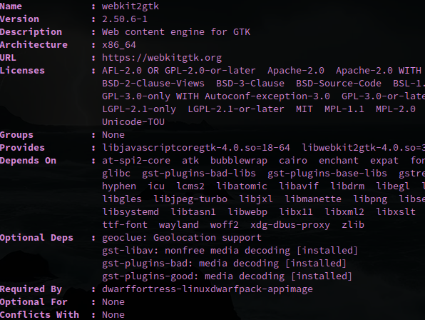

dwarffortress-linuxdwarfpack-appimage is listed as depending on webkit2gtk and i can see the same on the AUR page. But Last Updated: 2023-01-07 11:35 (UTC) so could be maintaining person simply needs to fix it.
Only way around would be removal of them both or put them both to ignore list.
these are needed to build the package webkit2gtk i bet.
But its now removed from arch repo and it tries to build it from sources, to make the package and install it.

But it will also remove dwarffortress-linuxdwarfpack-appimage as it is still set to depend on webkit2gtk and not webkit2gtk-4.1 ..
And as of that i gave you the other workaround options.. setting the installed webkit2gtk and dwarffortress-linuxdwarfpack-appimage to get excluded from updating till the maintaining person fixes the AUR build..

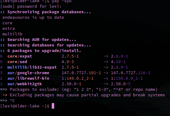

in your /etc/pacman.conf you have a line for the ignore action:
#IgnorePkg =
change it to:
IgnorePkg = webkit2gtk
With this it will not try to build it anymore and you should be able to update system..
https://aur.archlinux.org/packages/webkit2gtk-is-webkit2gtk-4-1 This is the one i was talking about it supposedly satisfies the dependencies but idk
Do i have to restart the system for it to actually ignore it? When i tried running yay _syu again it immediately tried to do it again
