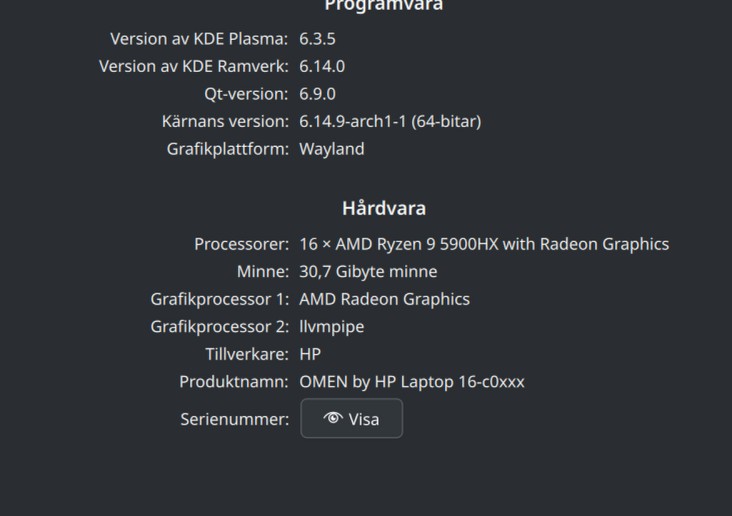

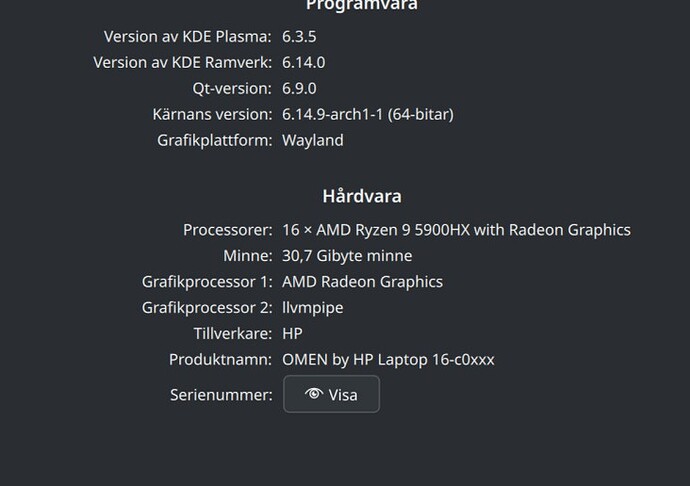

Hey,
when show software and hardware is strange thing:
Have an NVIDIA Corporation GA104M [GeForce RTX 3070 Mobile / Max-Q] (rev a1)
GPU 2 is llvmpipe but will have to GeForce RTX 3070 Mobile !!!
How can change that.

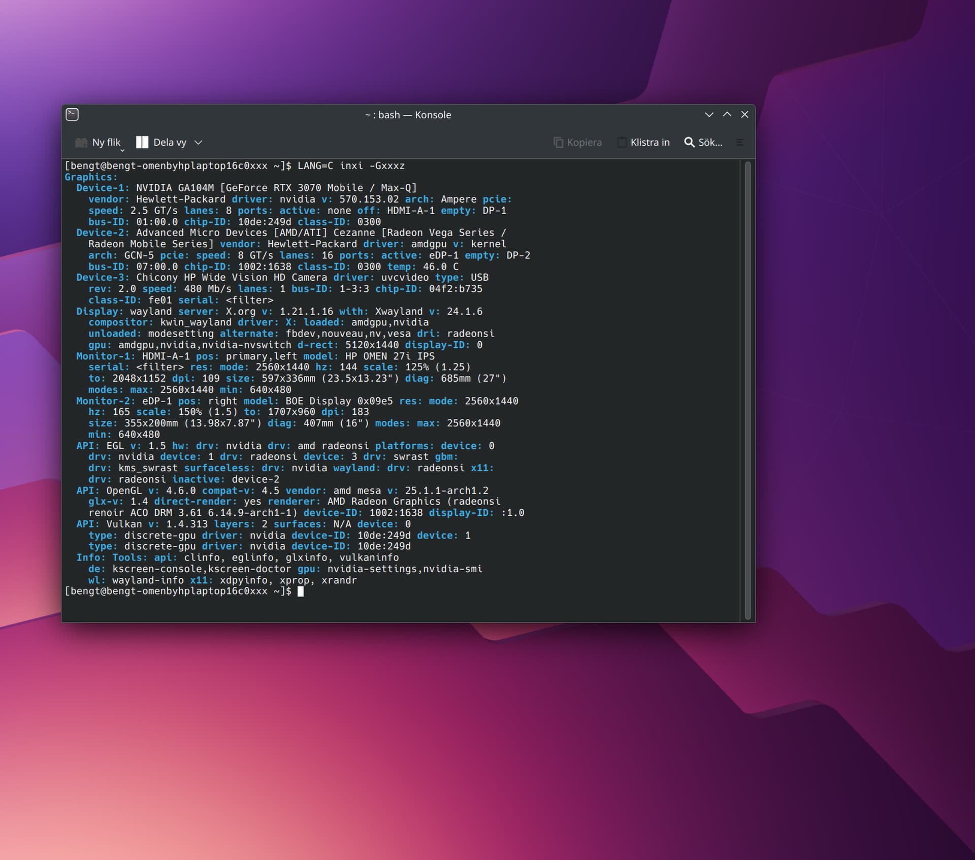

What does inxi -Gxxxz show? I wouldn’t worry overly about that screen if inxi is correct.

Open a terminal and type:
LANG=C inxi -Gxxxz
It should show a lot more information than that.
if (as dalto mentioned) the inxi is fine dont worry about it.
also since you want to game, check nvidia-smi . It will also show the driver version.
  • you may want to run nvidia-inst --32 as it will add stuff for gaming. check nvidia-inst -h for options.
For your games starting on the wrong monitor (i think this is what you mean) you can check the steam settings (if its installed on steam) or the games ingame settings, you should be able to fix it that way, else maybe KDE primary Monitor settings may work out?

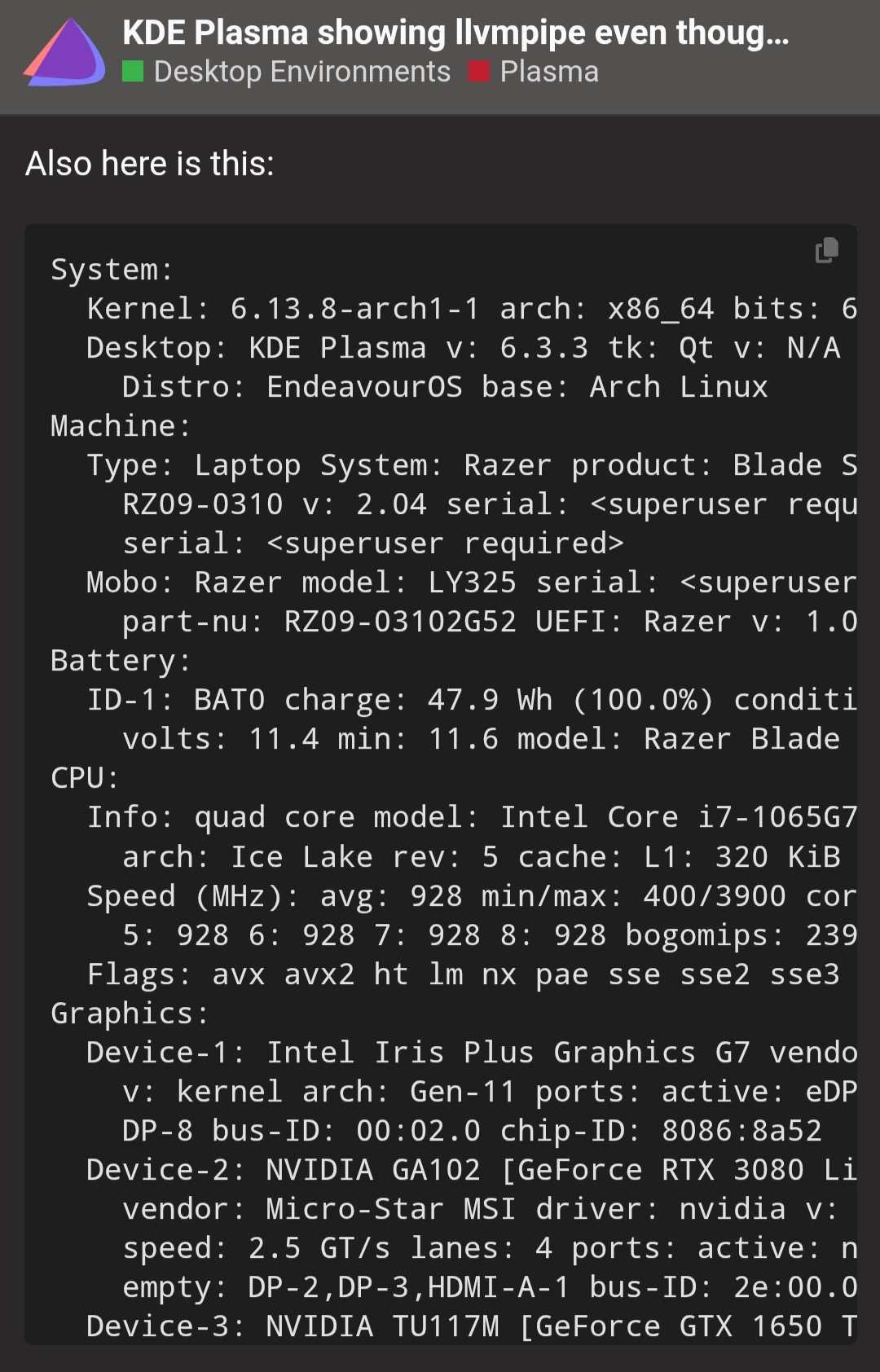

Also, if you are interested. I have the same issue, as you can see in this long thread, we came to the solution that its just a graphical error from KDE, nothing tragical. As games and everything else operate just fine.

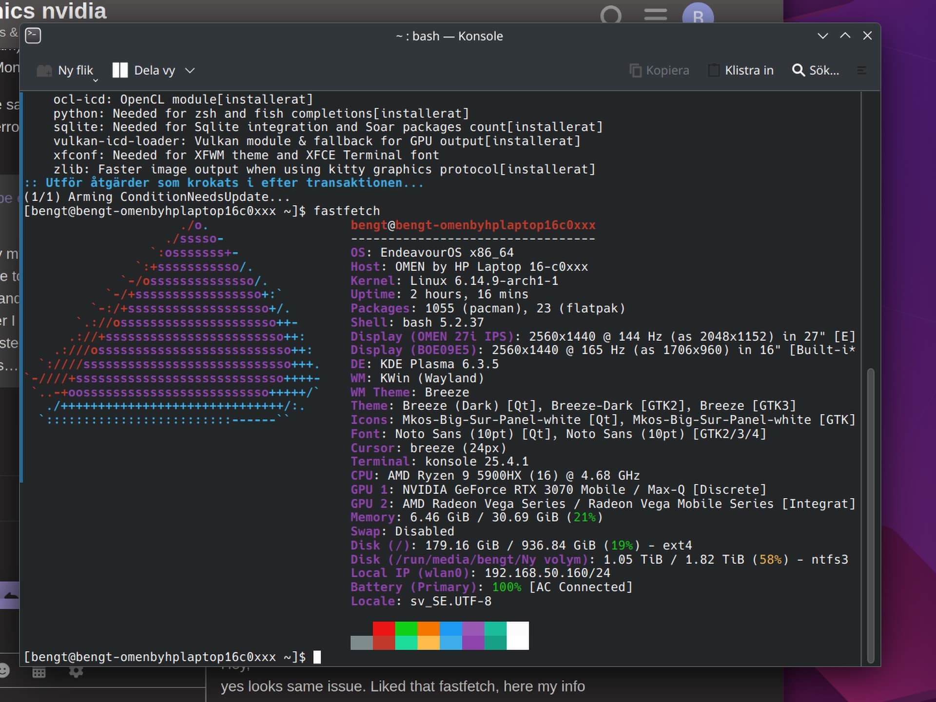

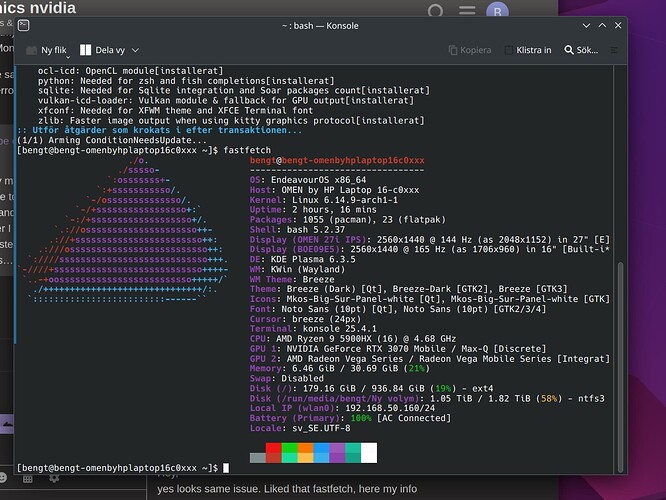

yes looks same issue. Liked that fastfetch, here my info
Cool that you have fastfetch installed. But we need the information from your inxi -Gxxxz output to help you as dalto already said.
If we don’t know what drivers you have installed, we can’t rule out where the problem is (as you still have not mentioned if the problem is just the KDE Systeminfo, or also performance in game or just the thing with your monitor?)

If you have no performance issues, then you likely have the same issue as me and a handful others.

I don’t see any issue. Yes endeavour does not show the correct name in the settings like Garuda does. But it’s a minor thing.
@Mellow already pointed to the thread where we talked about it :smiley:
Yeah, I don’t see an issue either. Unless you have a performance issue in your game, everything will be working completely fine. It’s just a KDE GUI error with the Systeminfo page (which only Fedora and Garuda provides a working fix for currently)
