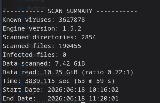

edit: did install /extra clamtk but I scanned /home and it was over in like 1/10th of a second and I thought “you go to be kidding this is a joke.” 1/10th? Really?
The command should be clamscan -r <path> right?
And I think for the first time, need to update database using sudo freshclam command.
eureka! it’s going to town now.
these things were not apparent when I did a clamav --help so next time I must rtfm :slight_smile:

took about an hour. this app has changed since I last used it.

I did try this and its GUI. When it scanned all of /home in 1/10th of a second I know something was wrong (me or them). It should have took 1-2 hours. So I uninstalled it and moved on. It has value. thank you. I was too stupid to operate it at the moment.
