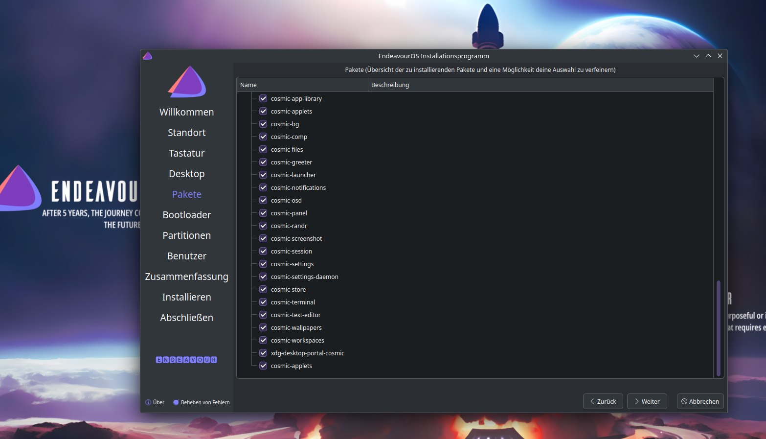

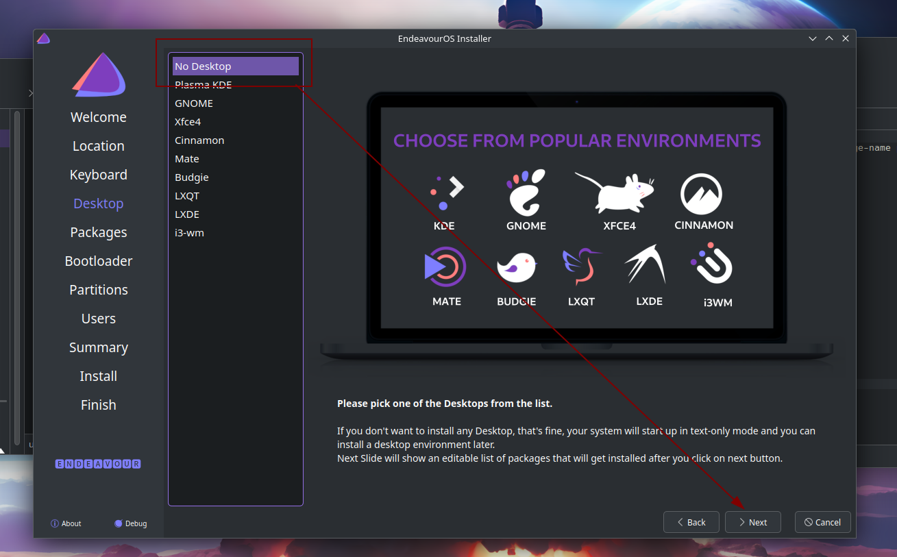

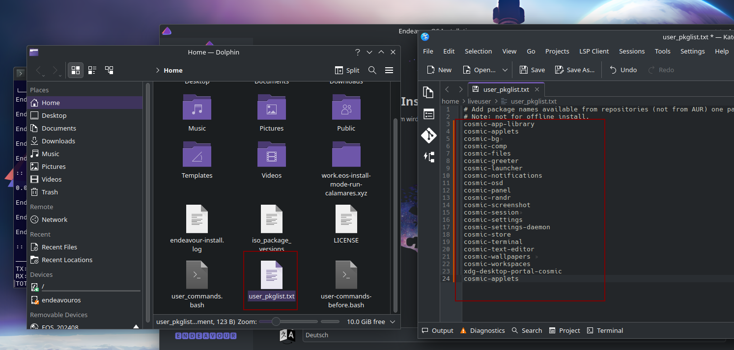

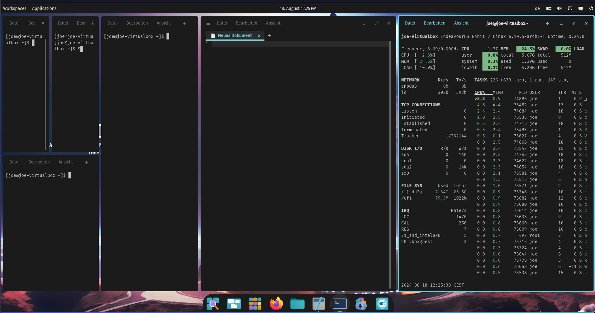

i used the user_pkglist option on EndeavourOS installer installing Cosmic alone not on top of other Desktop… but not using greetd and taken GDM as DM the packages list is this:
cosmic-app-library
cosmic-applets
cosmic-bg
cosmic-comp
cosmic-files
cosmic-greeter
cosmic-launcher
cosmic-notifications
cosmic-osd
cosmic-panel
cosmic-randr
cosmic-screenshot
cosmic-session
cosmic-settings
cosmic-settings-daemon
cosmic-store
cosmic-terminal
cosmic-text-editor
cosmic-wallpapers
cosmic-workspaces
xdg-desktop-portal-cosmic
cosmic-applets
gdm
Adding to /home/liveuser/user_pkglist.txt on ISO livesession and installing no-desktop (online):

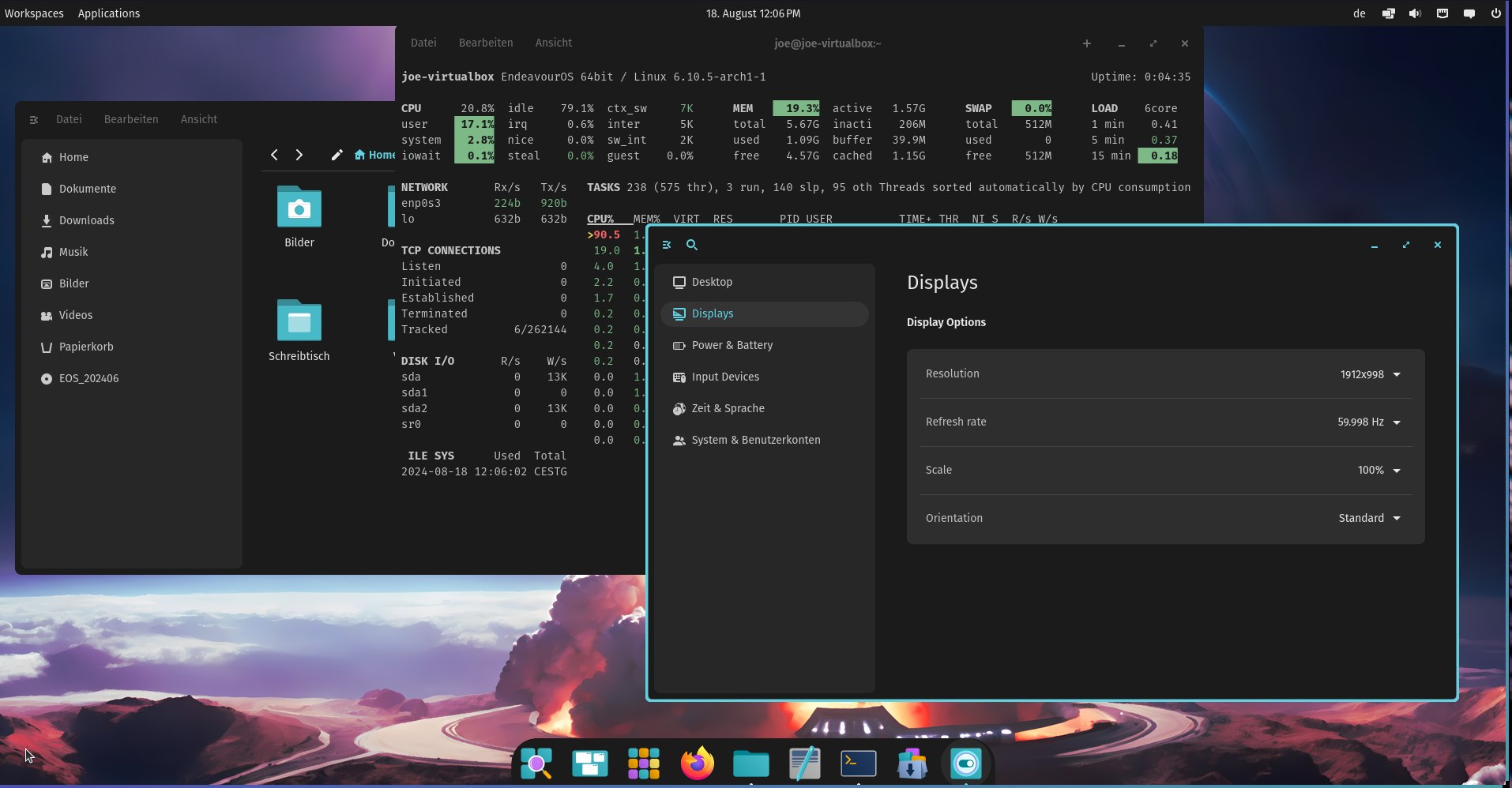

works pretty stable and complete.. only needs the right mindset or workflow to fit in .. it is not working for my brain.. tiling is a nice thing but its all way to wobbely for me.. i like my Desktop static.. basically
