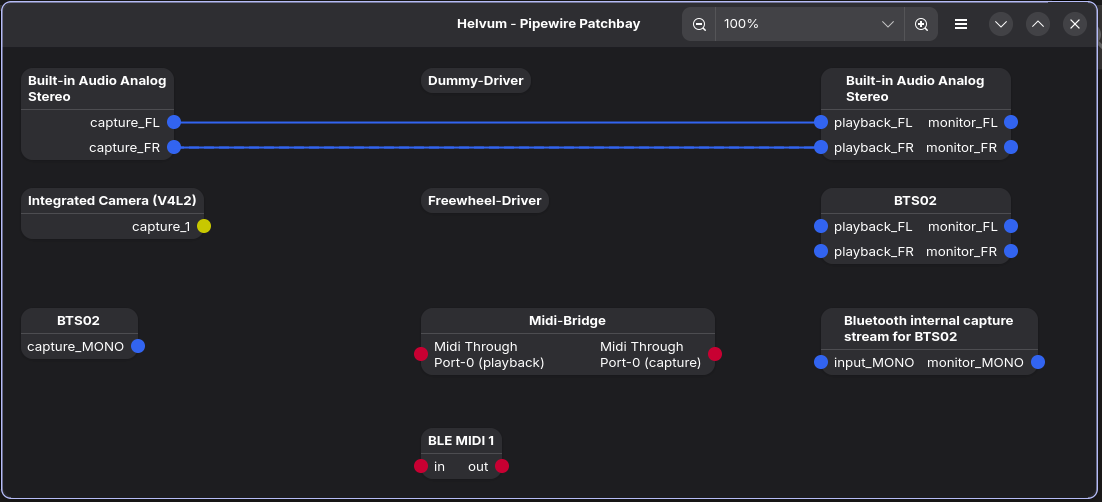

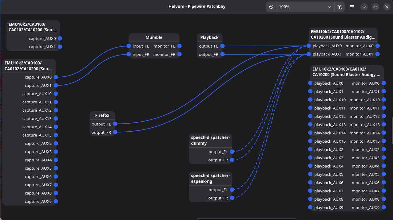

I ask with the courage of beginners, what does helvum show?

Hi, it says the same as qpwgraph since they do the same thing XD its showing up correctly. this is how it was when it was working
