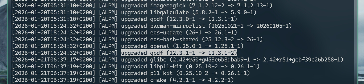

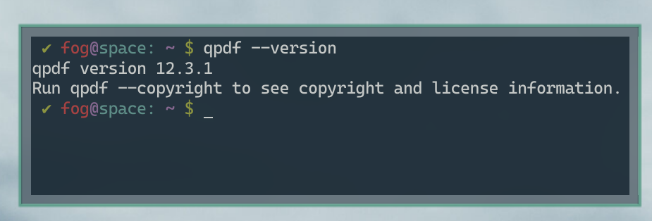

A week ago, I was also dealing with this issue.
Yesterday, I discovered that the problem had been solved without me having to downgrade.
Is your os fully updated?
Edit: Add screenshot:
