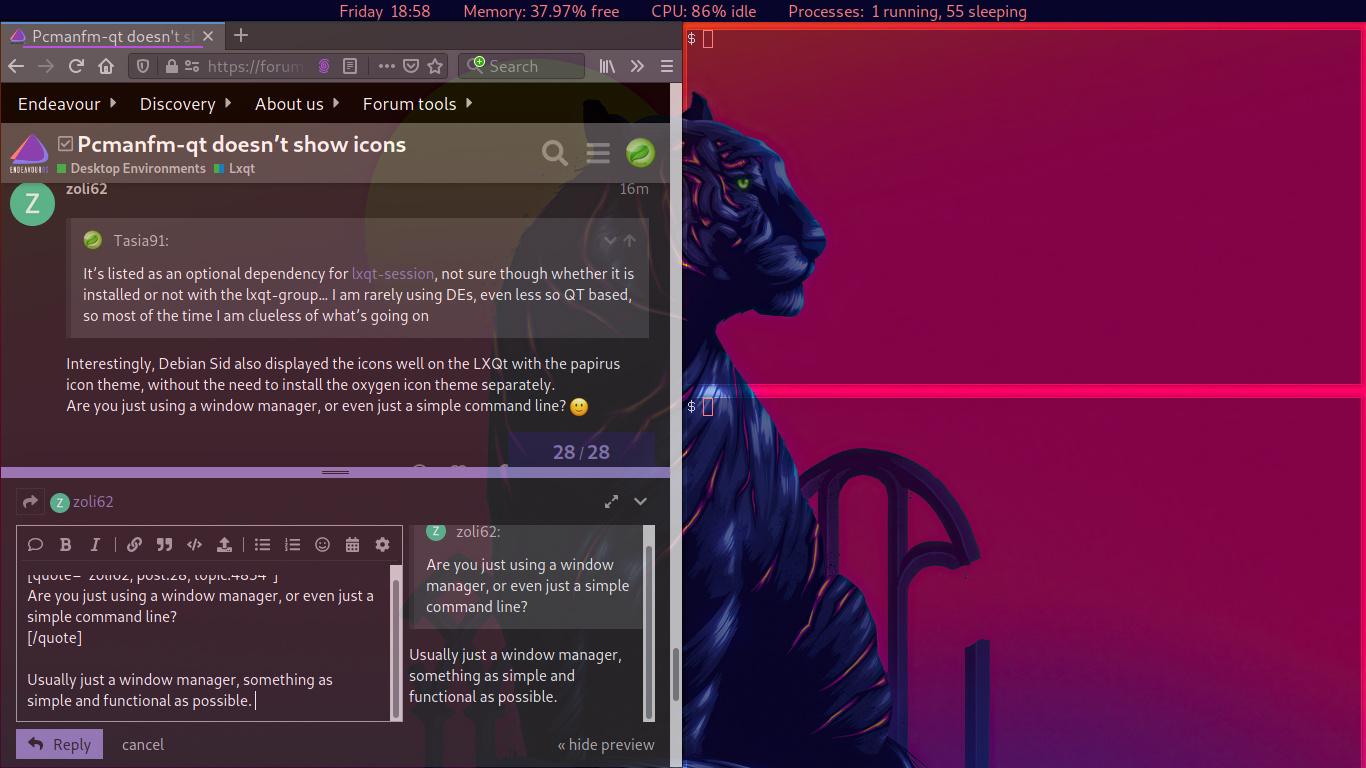

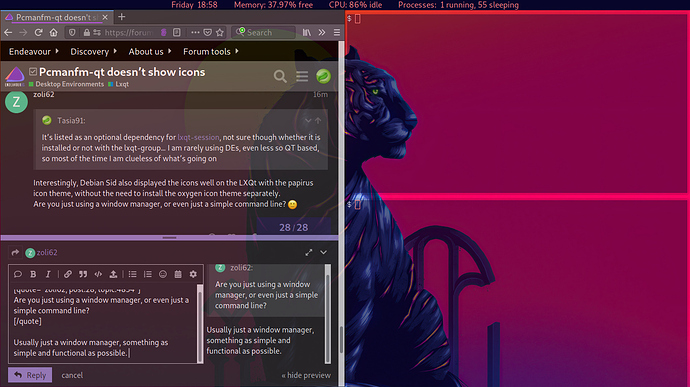

Are you just using a window manager, or even just a simple command line? :slight_smile:
Usually just a window manager, something as simple and functional as possible.
DEs sometimes add to much complexity
