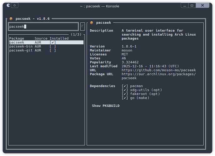

I’m using pacseek 1.8.6-1 and haven’t run into any issues.
Out of curiosity, how did you install pacseek, what source did you use? AUR?
