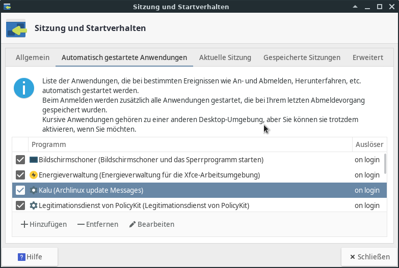

In additon it also still listed in startup applications:
I removed this entry, but after reboot the entry in notification settings is still thereā¦
Iāve been searching for you, just give me some time, I donāt understand why it isnāt completely removed.

Maybe there are some leftover files in ~/.config/kalu or /etc/xdg/autostart ?
