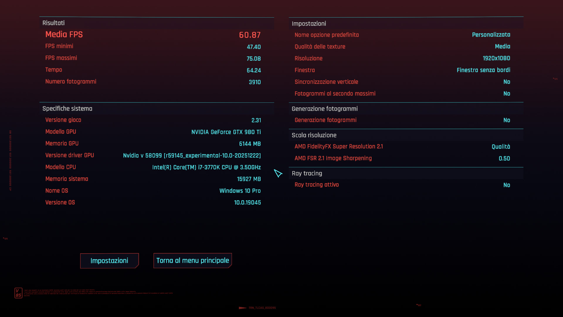

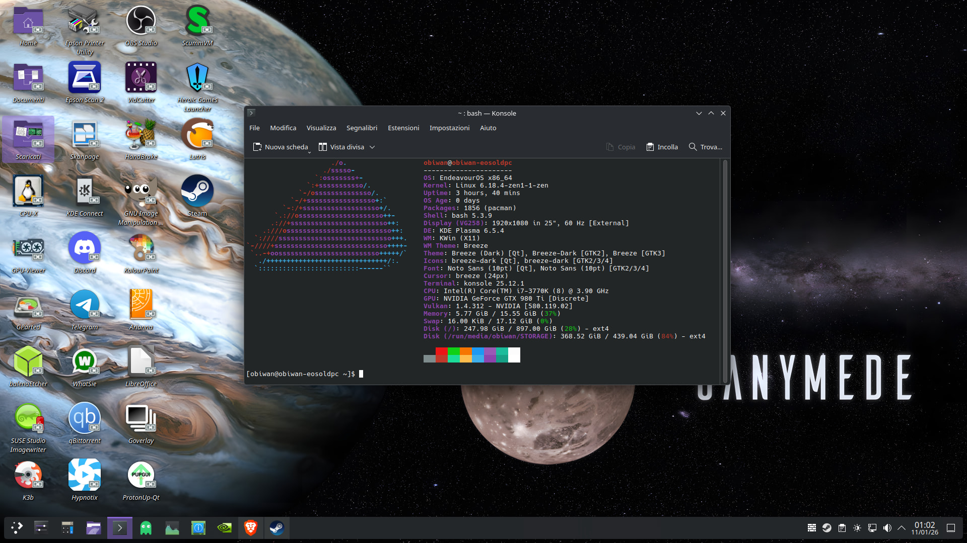

A question about the drivers, although it doesn’t concern my main PC (where I have an AMD CPU and GPU, so it doesn’t affect me), on the old PC that I need to keep running, from what I understand I should replace the proprietary drivers with the new ones because the new 590 version no longer supports older NVIDIA cards.
I have a 980 Ti (Maxwell architecture), and the proprietary drivers on Arch or EOS at version 580 worked fine.
Now, since I’m on another distro but could go back to Arch or EOS, I would need to use the LTS kernel for this old PC (I use a Wi-Fi router whose driver doesn’t work with the latest kernels).
From what I understand from reading here, I can switch to the AUR version of the 580 DKMS drivers. Am I correct?
If I installed EOS or Arch with the open drivers and then switched to the AUR DKMS drivers at version 580, is that possible?
And in the future, is there a chance they’ll be updated as well, perhaps excluding older cards like mine again?
PS: I also use my old computer for gaming, or to use AI to generate images in a lightweight way, with small models. So I also need CUDA features. Do the AUR drivers guarantee this?

Okay, I installed EOS, installed the Zen kernel, and installed the nvidia-580xx-dkms drivers, and everything worked fine. Everything works as it should.
