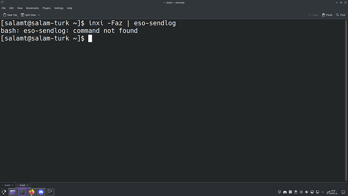

inxi -Faz | eos-sendlog
gave me this error (i am a noobie)
also my issue is caused by my widescreen so i need a fix for that
Sorry, I made a typo.
