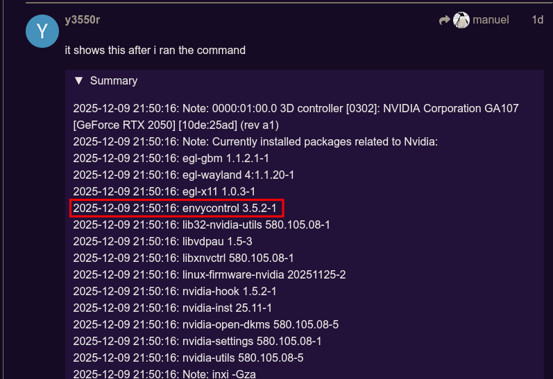

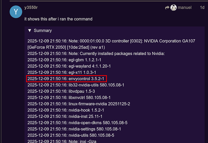

it shows this after i ran the command
Summary
2025-12-09 21:50:16: Note: 0000:01:00.0 3D controller [0302]: NVIDIA Corporation GA107 [GeForce RTX 2050] [10de:25ad] (rev a1)

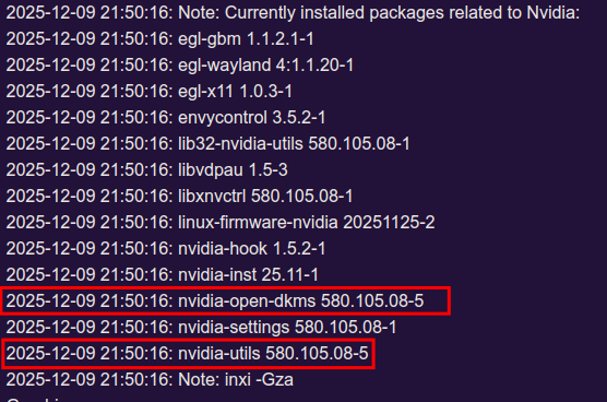

2025-12-09 21:50:16: Note: Currently installed packages related to Nvidia:
2025-12-09 21:50:16: egl-gbm 1.1.2.1-1
2025-12-09 21:50:16: egl-wayland 4:1.1.20-1
2025-12-09 21:50:16: egl-x11 1.0.3-1
2025-12-09 21:50:16: envycontrol 3.5.2-1
2025-12-09 21:50:16: lib32-nvidia-utils 580.105.08-1
2025-12-09 21:50:16: libvdpau 1.5-3
2025-12-09 21:50:16: libxnvctrl 580.105.08-1
2025-12-09 21:50:16: linux-firmware-nvidia 20251125-2
2025-12-09 21:50:16: nvidia-hook 1.5.2-1
2025-12-09 21:50:16: nvidia-inst 25.11-1
2025-12-09 21:50:16: nvidia-open-dkms 580.105.08-5
2025-12-09 21:50:16: nvidia-settings 580.105.08-1
2025-12-09 21:50:16: nvidia-utils 580.105.08-5
2025-12-09 21:50:16: Note: inxi -Gza

There was envycontrol installed. Maybe you used envycontrol and it blacklisted nvidia?

from what i remeber using integrated mode on envycontrol will blacklist nvidia:
  -s MODE, --switch MODE
                        Switch the graphics mode. Available choices: integrated, hybrid, nvidia
