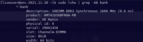

Could you run this program:
sudo lshw | grep -A8 bank
It is in package lshw if you don’t have it yet:
sudo pacman -S lshw

after several more retries, I gave up. I just tried Fedora 35 and it works fine:
if there are no other ideas, I guess I will wait for another ISO and try then.
gave it several more tries and now succeeded.
  1. bought new USB drive and tried with new ISO - same, not enough memory
  2. downloaded older ISO and booted - installed successfully. no errors during installation, even though it showed that I have 2 GB RAM.
After installation, it shows that there are 8 GB RAM on computer:
We are working on this to find the root cause, and hopefully have a fix or a workaround for the next ISO release.
The previous ISO is also a reasonable way to do a fresh install. A rolling distro will keep packages up to date all the time.
