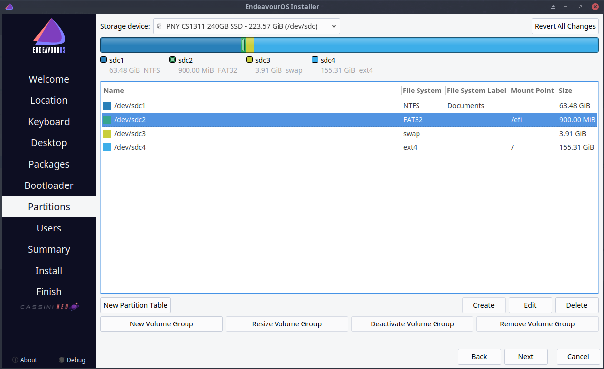

These screenshots from the USB stick version of Endeavour, I’m not sure if that changes anything. I’m trying to install with the Systemd bootloader because I heard that’s cooler :person_shrugging:
I did use manual partitioning, and this is installed alongside Windows, though Windows is installed on a separate drive.
My manual partitioning setup looked something like this screenshot, with the FAT partition mounted to /efi (I don’t see a /boot/efi option) and the ext4 mounted to /

My BIOS UEFI settings show two windows disks, which seems strange since the PNY disk only has Endeavor on it. The other disk is my actual Windows one.
It’s installed in DOS mode. Windows is installed in UEFI mode. You need to make sure Secure boot is off, CSM is disabled and install it in UEFI mode.
Edit: Problem is also you have this partition on the same disc.
/dev/sdc1            2048 133122047 133120000  63.5G  7 HPFS/NTFS/exFAT
Edit2: The disc needs to be GPT not DOS.
Disk /dev/sdc: 223.57 GiB, 240057409536 bytes, 468862128 sectors
Disk model: PNY CS1311 240GB
Units: sectors of 1 * 512 = 512 bytes
Sector size (logical/physical): 512 bytes / 512 bytes
I/O size (minimum/optimal): 512 bytes / 512 bytes
Disklabel type: dos
Disk identifier: 0x83f39799
Device     Boot     Start       End   Sectors   Size Id Type
/dev/sdc2  *    133122048 134965247   1843200   900M  b W95 FAT32
/dev/sdc3       134965248 143157247   8192000   3.9G 82 Linux swap / Solaris
/dev/sdc4       143157248 468857024 325699777 155.3G 83 Linux
Looks like you have documents on the same drive and the drive is in DOS. So i would get those documents backed up and off that disc and then create a GPT partition and install it in UEFI mode. You have to make sure CSM is off so the usb boots properly in UEFI mode.

I had a documents folder on sdc that I was foolishly trying to drag around with me. I just backed that up and threw it somewhere else for now. Currently wiping sdc with a fresh Endeavour install on GPT.
