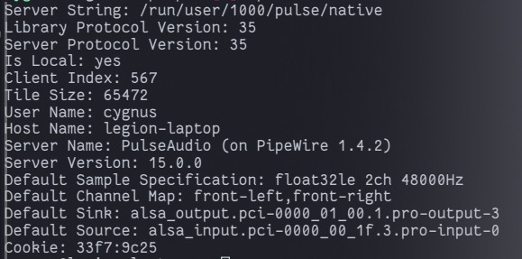

I am running basically a new EndeavorOS install. I would not even know how to change kernels.
Does this show enough information?
I turned volume up everywhere i could.

What is the output of inxi -Aa
inxi -Aa
Audio:
Device-1: Intel Raptor Lake High Definition Audio vendor: Lenovo
driver: snd_hda_intel v: kernel alternate: snd_soc_avs,snd_sof_pci_intel_tgl
bus-ID: 00:1f.3 chip-ID: 8086:7a50 class-ID: 0403
Device-2: NVIDIA vendor: Lenovo driver: snd_hda_intel v: kernel pcie:
gen: 1 speed: 2.5 GT/s lanes: 16 link-max: gen: 4 speed: 16 GT/s
bus-ID: 01:00.1 chip-ID: 10de:22bb class-ID: 0403
API: ALSA v: k6.14.3-arch1-1 status: kernel-api
tools: alsactl,alsamixer,amixer
Server-1: PipeWire v: 1.4.2 status: active with: 1: pipewire-pulse
4: pw-jack type: plugin tools: pactl,pw-cat,pw-cli,wpctl
