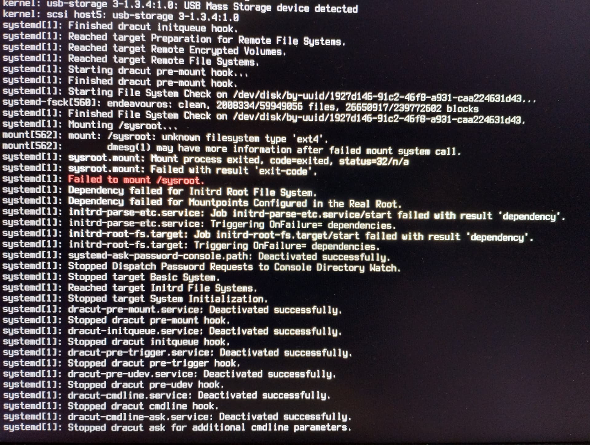

Since I have installed the linux-zen, as you suggested, I am unable to boot to linux-lts except for emergency shell. I can however boot to linux-zen. I get this message in the journal, but have no idea how to fix it and not mess it up even more.
To change the cmdline, you have to do it in the file /etc/kernel/cmdline. Once you rebuild with sudo dracut-rebuild, the above command line should be ported to /proc/cmdline/
@joekamprad : I am in the same situation as OP, with a lenovo legion pro as well. So they are definitely not alone.
Concerning linux-lts, the last update into it allowed only a basic system to load, asking me to go to root. Fallback was ok, though. Stable and zen kernels are ok.

this looks like initramfs is not correctly written ..

Ok, I thought dracut-rebuild was for systems with grub bootloader and reinstall-kernels was for systems with systemd-boot set up.
this is exactly for systemd-boot for grub it’s not. OP is using grub (as i think, not 100% sure what runs there) but reinstall-kernels and dracut-rebuild will regenerate initramfs boot images..
On grub you edit /etc/default/grub and regenerate grub.cfg sudo grub-mkconfig -o /boot/grub/grub.cfg
something with LTS kernel seems wrong after last update..
I see similar when using encryption.. hope its not about dracut..
