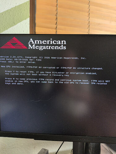

Hi, im simply confused. After updating BIOS i am unable to boot.
It doesnt matter which key i press, nothing goes on.
Sorry i am on My phone
Looks like you swapped the CPU, if you’re sure that N or Y does nothing, try reflashing your BIOS/UEFI. Or press DEL to disable the TPM.

Ok, I am back. I have to reset the complete BIOS via clm_cmos according to Gigabyte.
To press the key was simple fallacy.
I need to press zinstead of y :person_facepalming:
Going to reboot in BIOS now to set it up again

Uefi (Bios) firmware … what ever you want to call it does get corrupted sometimes and needs to be cleared. Usually a new bios flash does set it to the default settings in the new bios that was flashed. I sometimes reset the bios after the flashing. In most cases now newer motherboards automatically reboot when completed the flashing process. I think that secure boot and fTPM cause issues sometimes when it reboots.
The message ā€œfTPM/PSP NV corruptedā€ means your motherboard detected a new processor and its security memory chip needs to be reset to match the new hardware. I think this is where the corruption happens with the security memory chip. But I’m not an expert on this. Just my hunch.

That’s exactly what happened. I looked into it on the Gigabyte website, and as I said, a new setting for AMD_TPM had been implemented. I just didn’t know what that message meant. Had something gone wrong during the flash? Had I installed the wrong firmware? I was a little overwhelmed for a moment. Luckily, I managed to get everything working again.
@ricklinux this is the exact description at Gigabyte Hompage:
Update AM4 AGESA ComboV2 1.2.0.12 Fix AMD TPM Reference Code Errata (CVE-2026-6726, CVE-2026-6727)

Exactly, and I didn’t pay attention to that. I just wanted to update the BIOS from F18g (Mar 11, 2025) to F20c (Aug 18, 2026)—the latest version. So I just downloaded 20c, and after flashing it, I wondered why nothing was working anymore :rofl:
That was actually the first time an error occurred. Maybe it wasn’t even a big deal. In any case, after the second or third boot, I noticed that the keyboard was set to the American layout in that mode. In the German layout, ā€œyā€ is ā€œz,ā€ and in the American layout, ā€˜z’ is ā€œy.ā€ Maybe that’s where the error was. Anyway, I reset everything and cleaned the inside of the case—it was already open anyway. So everything’s taken care of, all for the best.
