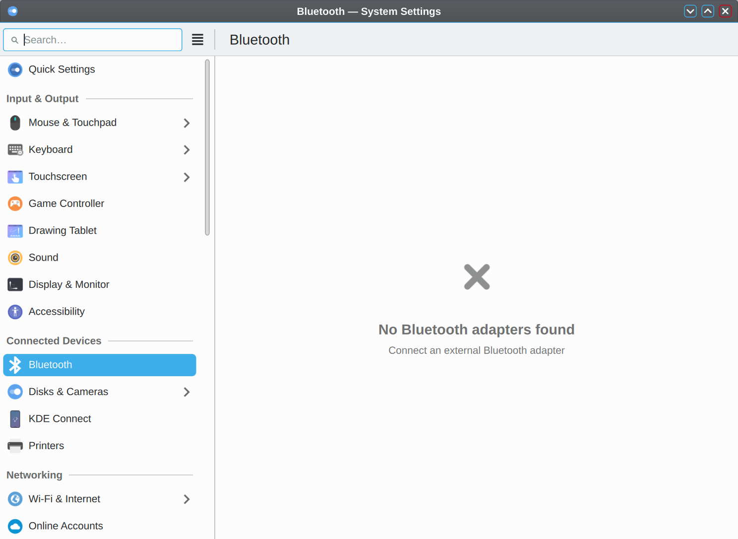

No Bluetooth Adapters Found
I have no idea what happened. My Bluetooth mouse was no longer working. Then I noticed the Bluetooth icon missing from the system tray. Nothing in settings either…
I ran sudo systemctl enable bluetooth, nothing.
I reinstalled the Bluetooth utilities: yay -S bluez bluez-utils bluedevil, rebooted, ran sudo systemctl enable bluetooth again, nothing.

Very strange. I used my truobleshooting user account and the same thing was happening. But after updating this morning, all is well and Bluetooth is working and available again.
Yesterday morning:
❯ inxi -Eaz
Bluetooth:
  Message: No bluetooth data found.
This morning after updating:
❯ inxi -Eaz
Bluetooth:
  Device-1: Realtek Bluetooth Radio driver: btusb v: 0.8 type: USB rev: 1.1
    speed: 12 Mb/s lanes: 1 mode: 1.1 bus-ID: 1-5:4 chip-ID: 0bda:c821
    class-ID: e001 serial: <filter>
  Report: btmgmt ID: hci0 rfk-id: 0 state: up address: <filter> bt-v: 4.2
    lmp-v: 8 status: discoverable: no pairing: no class-ID: 6c0104
Oh, well. I guess I shouldn’t complain, it’s working again. But I am curious as to why Bluetooth was completely gone between updates.
