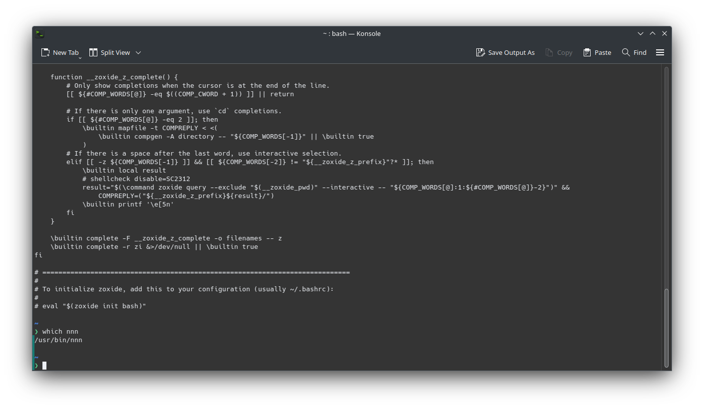

Could something be wrong with the nnn executable?
What’s the output of which nnn
which nnn screenshot
