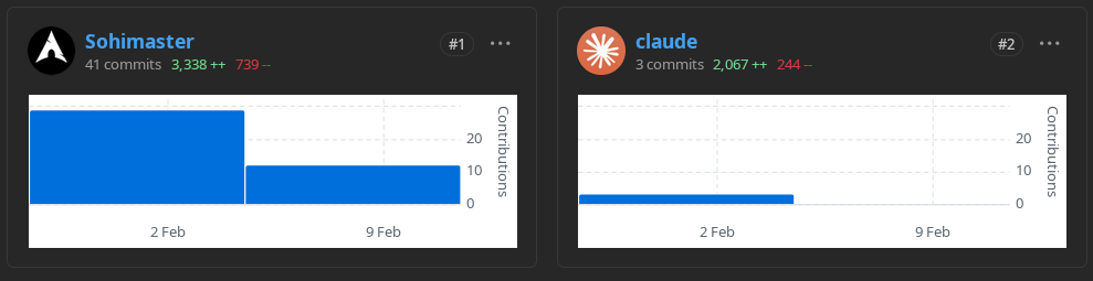

And it seems like the dev utilizes claude in some way, it’s uncertain to which degree actually. But there is an CLAUDE.md file in the repo, which is a strong indication that Claude Code is utilized within that code base.
That isn’t automatically a bad thing, but if you check the currently open issues, such as this one, which essentially cconcludes that last years AUR incident would go undetected by this application as the code won’t check the installation scripts which are being utilizted within a PKGBUILD.
Haven’t reviewed the code myself, but it seems like that the code just analyses PKGBUILDs and within the context of last years malware incident, the malicious code wasn’t included in them directly, but were referenced in external installations script. This would be a big oversight, as the dev claims to address the attack vectors of last years attacks.
Nevertheless, if you additionally check the repositories the dev has forked or which are published by him, this is the very first project written in rust. And among his other repos are things like crypto converter written in python and realtime crypto price comparison written in JavaScript. I don’t see any evidence of an profound security related background.
Sure, it could just be the case that the dev is just trying to establish himself with this project, and if he does utilize Claude Code to a certain degree, e.g. syntax checking and documentation purposes, it’s totally legitimate to automate some steps - as long as it’s not the whole code base which is written by claude code.
