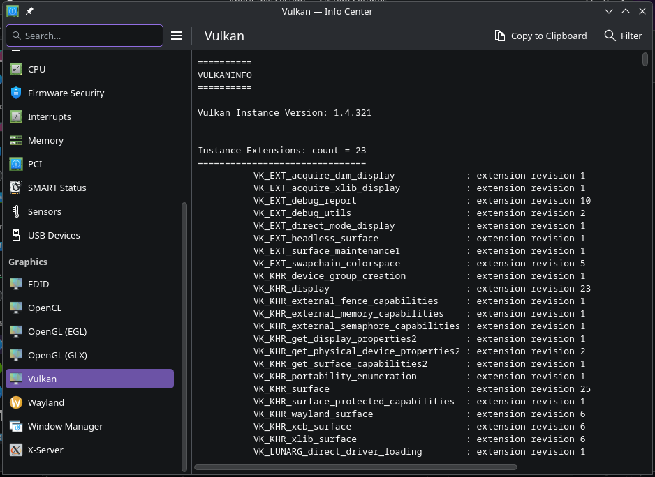

I realized that endevour does not come with vulkan preinstalled. Is there a reason?
OK i had issues with video playback but the solution was easy. Setting the correct output (opengl) and for hw acceleration it is “va-api video decoder”.
Once you set these in VLC (i removed haruna), x265 1080p videos play fine.
As per our Package Lists, namely base-packages.txt base-device-addons.txt and DE-pkglist.txt , we do not install Vulkan by default on anything. But it seems, at least with KDE Plasma, that Vulkan is installed as dependencies for some app(s).
