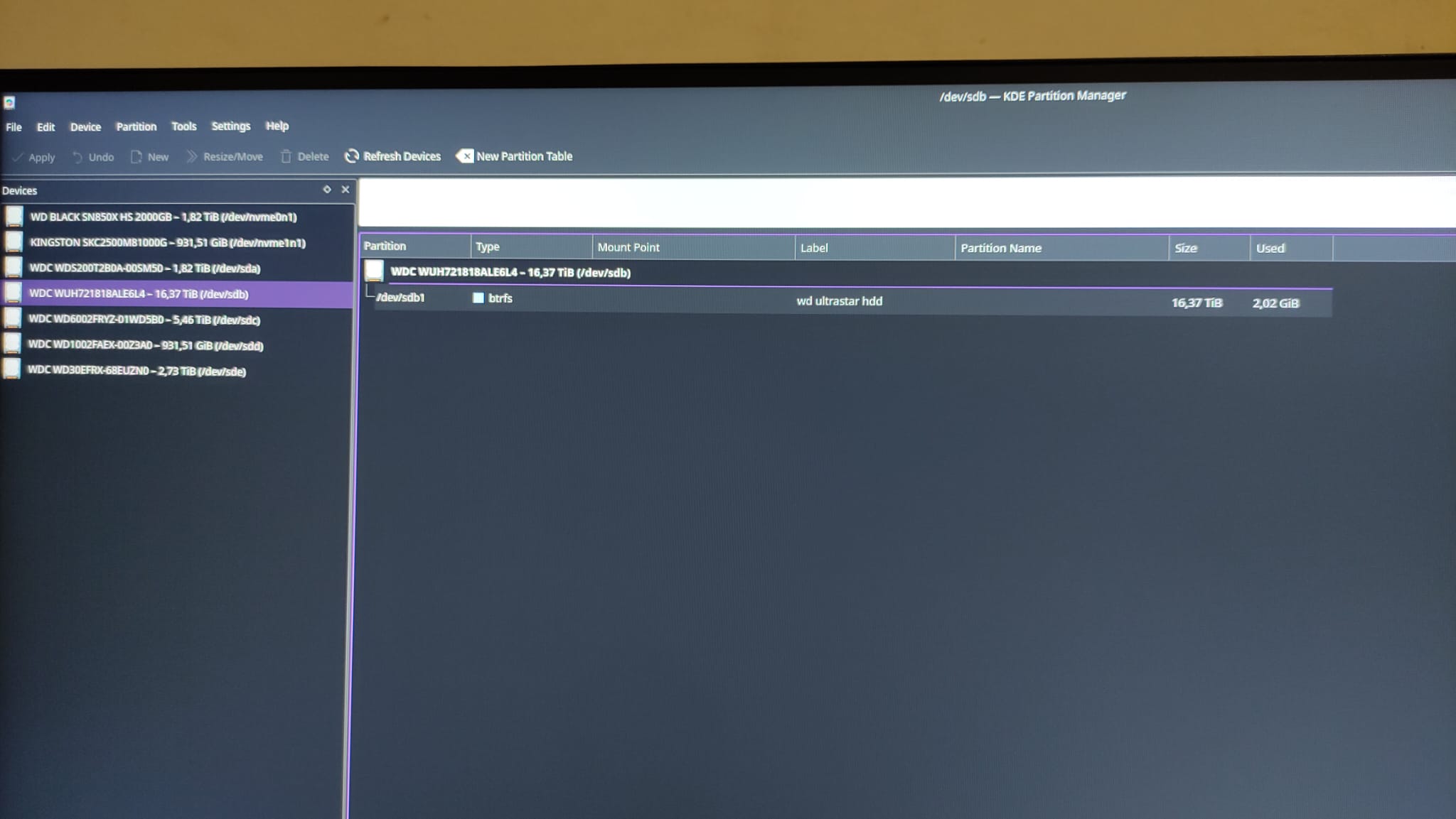

New hdd formated with btrfs question
2gb reserved right of the bat, after formating the new drive with btrfs??

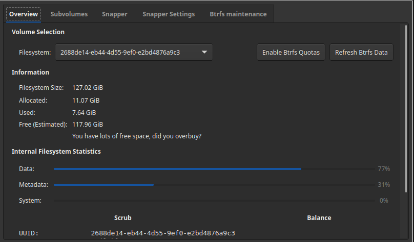

@BluishHumility is right…may I suggest you to check the BTRFS Assistant by @dalto…it not only shows FS usage, but allows you to deal in an easier way with Snapper and the maintenance tools

i have btrfs assistant installed will look later when i switch to linux if i can see something there…
and that other method i write btrfs filesystem df /run/media/enio/wd ultrastar hdd ?
The overview tab shows disk usage information.

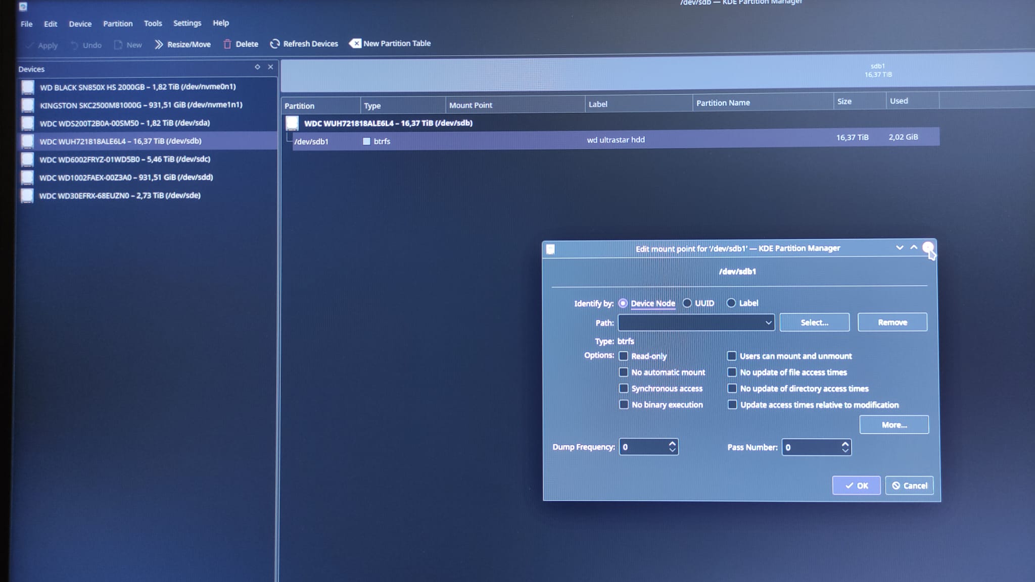

it is just the label that is wd ultrastar hdd, does that matter?
it says something about identify by device node
Normally you would not use a partitioning tool for renaming a directory. However, in your case it looks like you are using an auto-mounting tool and it is setting up a mount point based on the label for the filesystem.
Try renaming the label (you may need to unmount the device first) to something without spaces, such as wd_ultrastar_hdd or something like that. Then allow the system to auto-mount and see if it uses the amended label name for the mount point.
i did fire up assistant,to see if i can see something there. the only disk i see there (similar like you showed on this picture) is my nvme which has linux installed on it. the other hdds are not visible there, i dont see an option to check other disks.
It is a great program tho, it should be standard when installing btrfs… oh and i did what you suggested, changed the name of the label, instead of spaces i put _ just to complicate things less.
You can switch to another filesystem here:
i think i have only one option, i clicked that before, i will need to check again when i boot up linux.
update, i was right, there is only one choice there…
