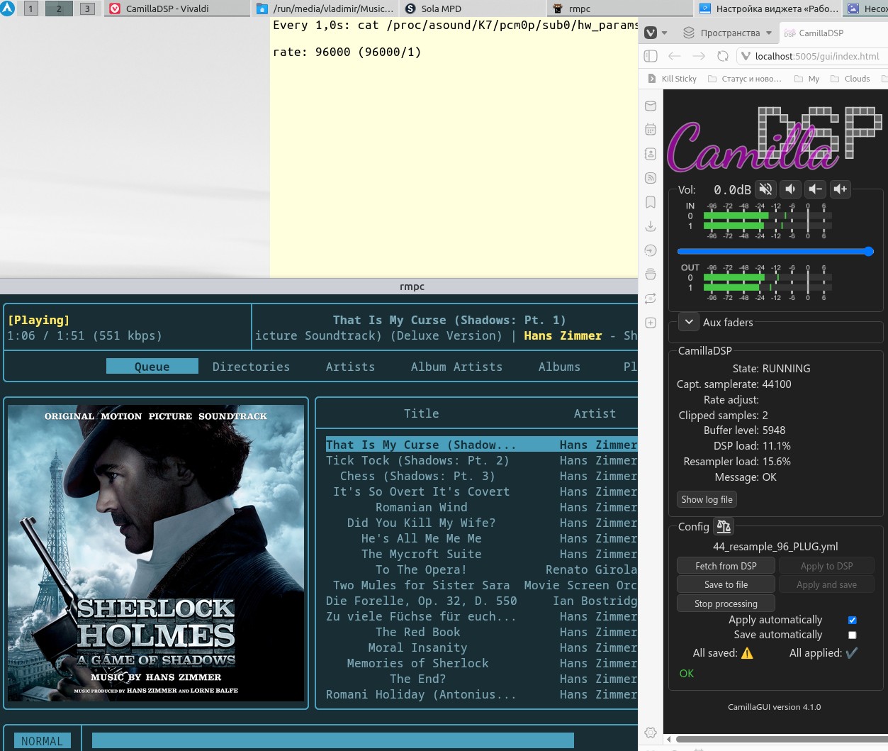

But a new inconvenience arose – the need to reconfigure both mpd and the local player to work with EasyEffects (using IEMs) and with CamillaDSP (listening through speakers). In the end, for the mpd use case, I wrote “on” and “off” scripts. The “on” script creates a loopback, starts CamillaDSP, its interface, opens the browser page with it, and switches mpd to use the CamillaDSP processing chain. When using the “off” script, all of this is shut down and mpd is switched to using ALSA.
So the final software chain looks like this:
· Listening with IEMs using mpd and Fooyin through EasyEffects.
· Listening through speakers using mpd and Audacious (configured to work with CamillaDSP) through CamillaDSP with the “on” script activated.
I don’t switch between IEMs and speakers every five minutes, so I don’t see any significant difficulties in using this setup.
