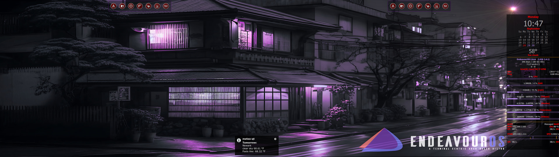

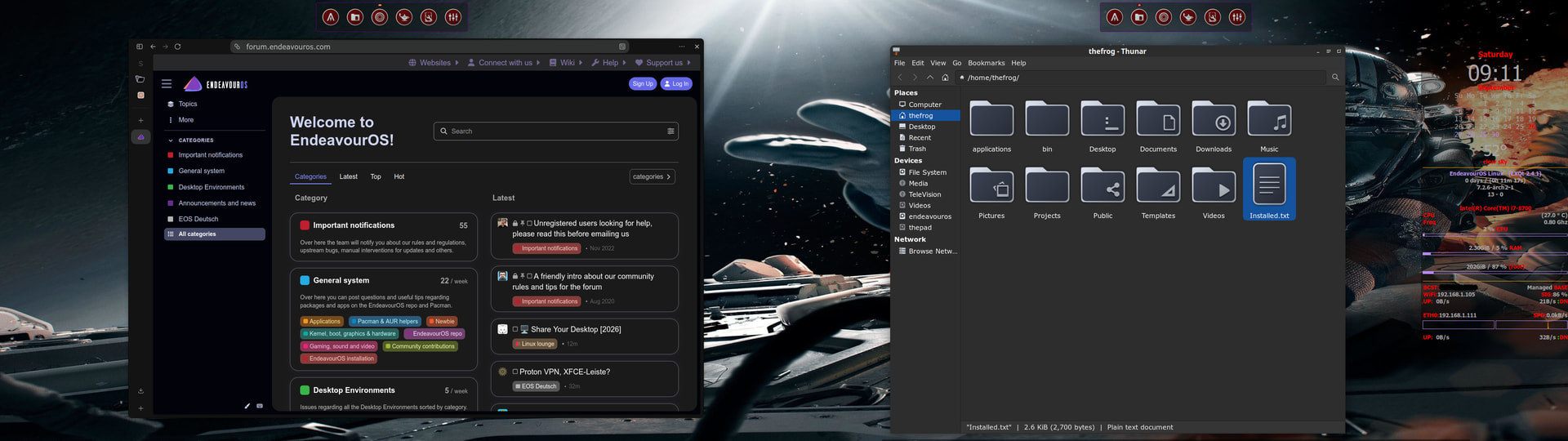

Here it is on my daily. Only issue with transfer was of course my conky :roll_eyes: however I was finally able to solve that issue. And Now here it is in its glory :grin:

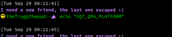

What does:
echo "$QT_QPA_PLATFORM"
Return?
Space the final frontier :grin:

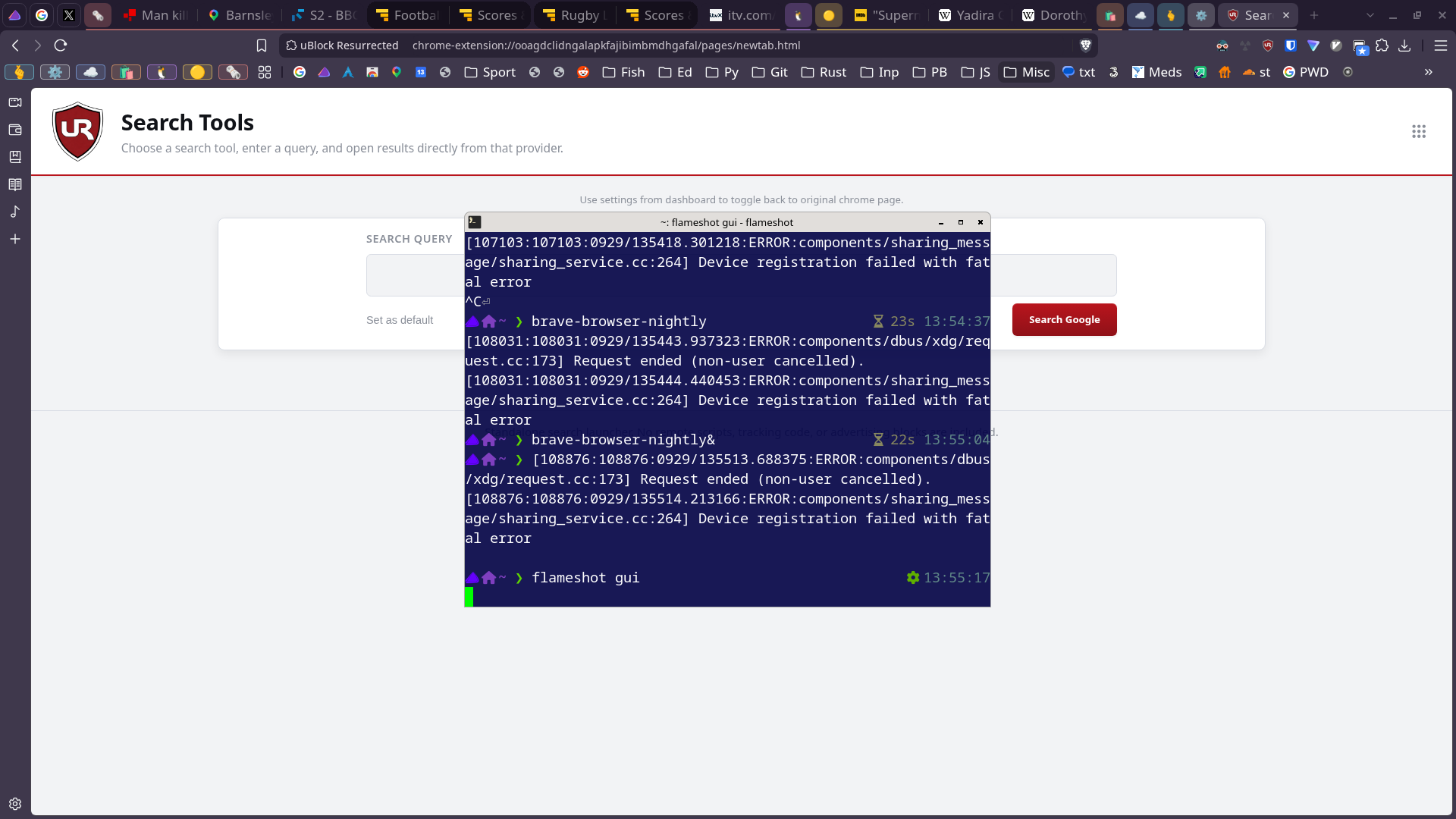

I booted into labwc, launched brave (nightly, don’t have standard installed), runs no issue.
I’m thinking it has something to do with me running brave-bin. Helium works so If I need a chrome type browser in wayland then I can run that.
