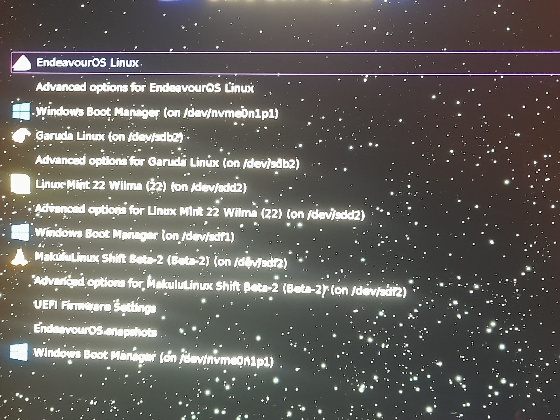

And this is the situation at reboot:
Reboot menù
If it can be solved, is there a simple way to do it (i.e. to be able to select opensuse at startup)?

Oh, another thing, arch-based distros regardless of the file system (ext4, btfrs etc.) are detected and can be selected without problems.
Other distros are detected and can be selected only if they have the ext4 file system, such as openSUSE. If I were to reinstall it in ext4, I could also select it at startup. But in the current case it is in btrfs.
Other distros like debian instead, are detected and can be booted even with fs in btfrs.

If I install opensuse with the file system in ext4 it detects it and it is also selectable. Not all os with the fs in btfrs are added completely.
Debian and some derivatives yes, from what I have seen, other distros like in this case no. Personally I could not say the reason for this, but I imagine that someone more expert than me can trace why this happens.
Tumbleweed’s grub detects all the distros, but EOS and Garuda won’t load them because it can’t find the correct address.
I have just explained the why in my previous post.
The question is what do you want to do now?, so that you get relevant advice :man_shrugging: .
If you want to use EnOS bootloader to boot OpenSuse, I suggest you ask at OpenSuse support for info. As explained, distros usually customize their bootloaders code, but I wouldn’t care to get educated more. Archlinux and derivatives fulfil my needs (and fill up my spare time) :smile: .
By experience, I always recommend multi-boot users, especially those experimenting/distro-hopping, to use UEFI boot menu for each OS, using that OS’s native bootloader. It is the easiest and more trusted method.
Thanks. I think I’ll install some other distro instead of tumbleweed. After all, I prefer to complicate my life by having a bootloader from a distro (be it grub or something else, but personally I’m only a little familiar with grub) start all the others, rather than starting them manually from the bios. XD
Another option is to use /etc/grub.d/40_custom to setup chain-loading of other distros’ GRUB, similar to how Windows Boot Loader is chain-loaded. I made an answer here to that question - https://unix.stackexchange.com/questions/660393/how-can-i-chain-load-grub-from-systemd-boot. It’s specific to systemd-boot, but the concept is the same.
Obviously this will take more manual work in the beginning. But once done, your new distro entries will always be there, and changes to a distro’s boot specifications (openSUSE is switching to BLSCFG soon, like what Fedora has now) will not affect your GRUB menu.
In a nutshell, this does exactly what @petsam suggests, just within your GRUB menu.
