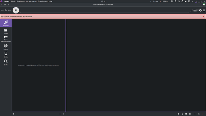

What error exactly are you facing?
MPD is working according to the logs.
i cant see no error. all i can say cantata did not start
Could you post the config file from /home/swh/.config/mpd/mpd.conf
of course

Replace your /etc/mpd.conf file with what you just posted, and make following changes.
Comment this out.
Uncomment this, and replace nobody with your user, swh
Then stop, and start mpd.
systemctl --user stop mpd
systemctl --user start mpd
looks good
❯ systemctl --user status mpd
● mpd.service - Music Player Daemon
     Loaded: loaded (/usr/lib/systemd/user/mpd.service; disabled; preset: enabled)
     Active: active (running) since Sat 2023-03-11 16:02:33 CET; 6s ago
       Docs: man:mpd(1)
             man:mpd.conf(5)
   Main PID: 28946 (mpd)
      Tasks: 3 (limit: 18374)
     Memory: 9.9M
        CPU: 46ms
     CGroup: /user.slice/user-1000.slice/user@1000.service/app.slice/mpd.service
             └─28946 /usr/bin/mpd --systemd
Mär 11 16:02:33 ryzen systemd[1016]: Starting Music Player Daemon...
Mär 11 16:02:33 ryzen mpd[28946]: decoder: Decoder plugin 'wildmidi' is unavailable: configuration file does not exist: /etc/timidity/>
Mär 11 16:02:33 ryzen systemd[1016]: Started Music Player Daemon.
but call me idiot, i accidently delete my cantata.conf file right now…but that may not matter, cantata is creating one again.
Okay this time MPD is working and audio outputs also detected.
Guess we should fix cantata now.
Lets try running cantata with debug.
cantata --debug all
Share the log after running it.
One mistake from my side too :upside_down_face:
This line should be moved at the very top of /etc/mpd.conf
I forgot to say this earlier
Cantata runs again. I just need to set it up again
do i have to do this step?
Yes yes. You need to. Otherwise it won’t read music folder from your user directory.
@flyingcakes you are my hero for today…everything runs smooth again
Thank you a thousand times !!!
You are the hero :wink:
Now I know I need to update the wiki post for users relying on systemd service :sweat_smile:
we both are :smiley:
just one question. how do is set systemctl --user mpd to permanent?
is it right with: systemctl --user enable mpd?
Yes
Make sure to disable the system wide service in case you enabled it earlier.
systemctl disable mpd
