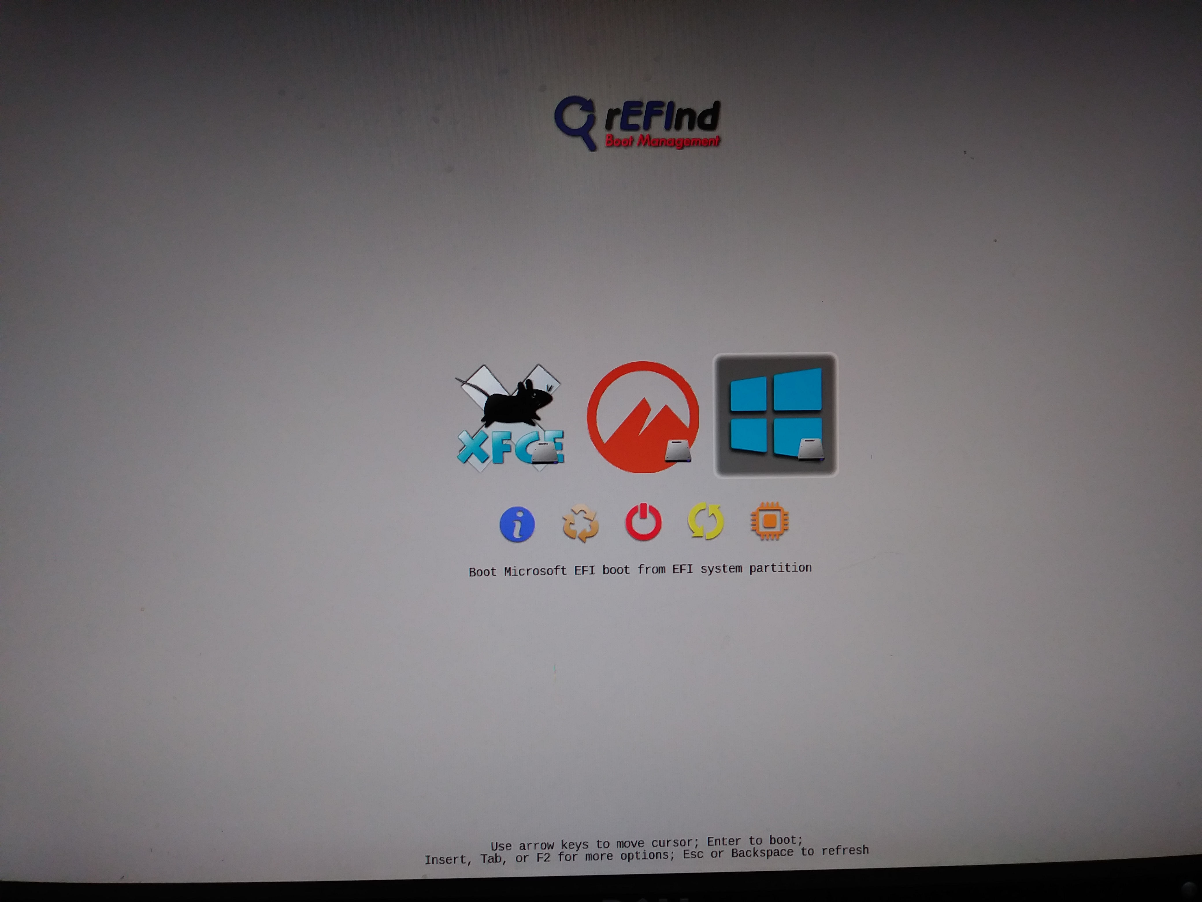

Well - how you get it there is immaterial - but booting into it is one easy way. Wherever you have the logo, just
sudo cp logoname.png /boot/vmlinuz-linux.png
that assumes you did boot into the destination distro of course!
And it assumes you’re in an EndeavourOS install too!

20200528_143606
Okay so that’s pretty easy! Now i label the partitions and what does that do for me?
I do understand the command …i just don’t do enough of it. So i have to think too hard! :face_with_head_bandage:
It just makes it easier to figure what you’re booting from. You’ll notice it says something like Boot /boot/vmlinuz-linux from filesystem-name when you select one of the non-Windows entries. Examples can be seen on the screenshots in the wiki on rEFInd…
So do you have xfce on your ssd to do your work from as shown in the case study? I also notice xfce in the list of the 9 partitions. Just wondering?
On that machine, the ‘daily driver’ is the EndeavourOS logo, pointing to a /root /home split on the SSD - and yes, it is XFCE.

It also looks like you didn’t find the “take a screenshot” key! F10 doesn’t always work though…, but when it does you get a .bmp file in the top level of the ESP (/boot/efi on most EndaevourOS)
Actually i had forgotten about it but you’re right sometimes it doesn’t work. I never had any issues with Deepin 15 but then V20 was not working at all. But now it’s okay since i figured out that trick of turning on the windows effects. It’s totally the opposite as i have to turn window effects off on cinnamon.
Edit: The F10 is working but how do you copy the file from the folder as i tried using sudo thunar as root and when i copy the file and paste it into a folder it is locked when i go to the folder.
You might need an AMD threadripper!
I use the Thunar ‘open folder as root’ option, and copy the bmp to ~/Pictures dir - then convert it to something more useful. Do you have a bunch of things like that option in your Thunar? It makes life much easier :grin:
