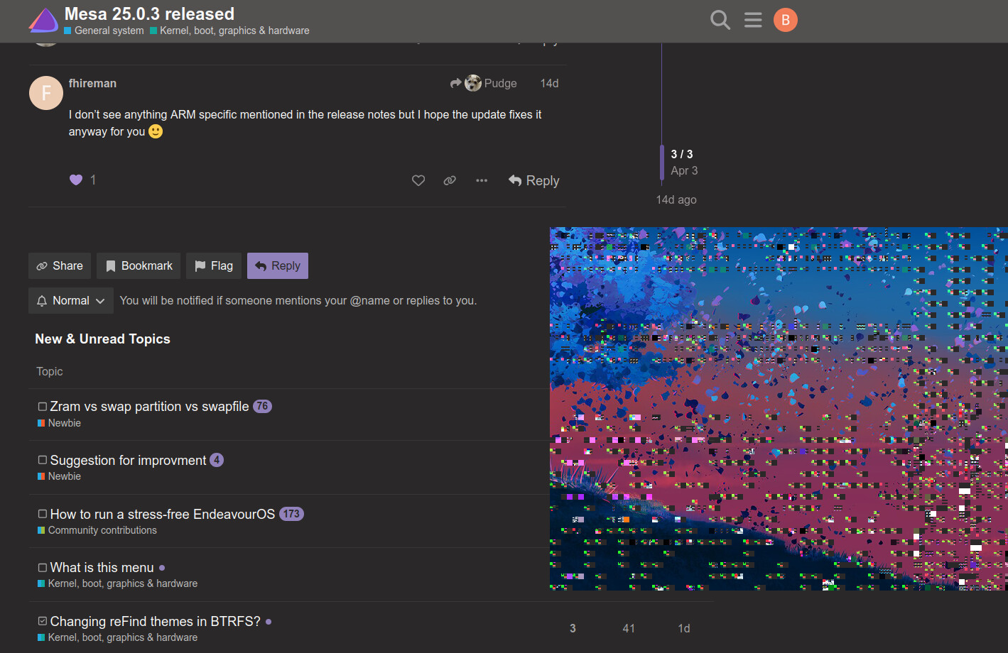

I only updated my system yesterday and on my external monitor I still get artifacts (here is a screenshot of this very conversation ). Although it seems to be slightly better (judging only from these last few hours), the issue is not fixed as I can sometimes see my wallpaper through Firefox !
P.S. I see 25.0.4 dropped (although not in extra) so I might try it out and see how it goes.
