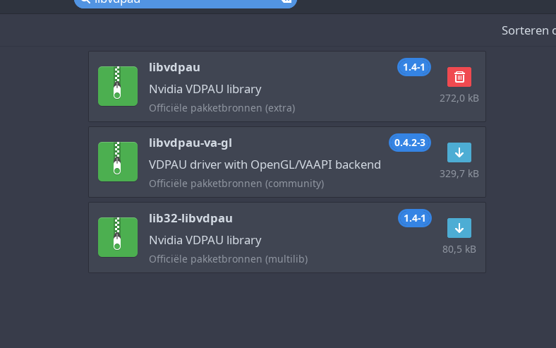

Been searching in the old interwebs and all I could find was that I may have to install libvdpau-va-gl instead of using libvdpau, since this is needed for Nvidia based gpu’s.
I did so but this didn’t work.
2021-12-13_14-13
Anything I could do, or reinstall Kodi?
