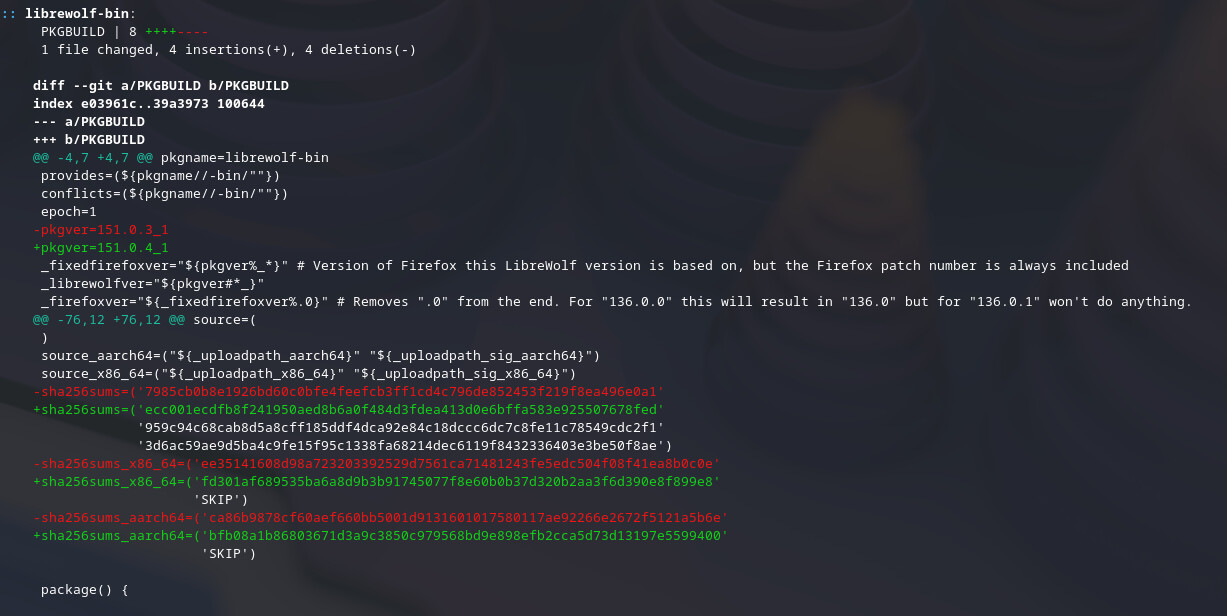

On the other hand, if you simply enable diffs in your AUR helper, all these attacks would stand out in a fairly obvious way on update even if you don’t have any particular technical experience.

after this I will enable diffs in yay, but even with that you have to be meticulous, because they can be shady in a 6 line diff too, for example changing the domain to something similar or the rest of the link that will get a bad file from a server.

That’s the beauty of the diff output though, even if it looks similar it screams at you that something changed: Look at it until you find the difference.

In most case all you will see is something like this:
An easy to read, color coded diff that clearly shows that nothing changes except the version and the package version and the checksums. Other times you might see changelogs here as well.
These changes and any non-code changes like changelogs should be generally safe.
If anything else changes, it needs inspection. If you have the ability to inspect them yourself, great. If you don’t, there are a couple of things you can do:

Can you give an example of something that could change that wouldn’t show up in a diff? The diffs usually include all the file changes, not just the PKGBUILD.
what do you use for this, I set diffmenu=true in the yay config, but it just prints the every file

what am I doing wrong with yay? I don’t get a diff like the one @dalto posted
Are you purging your yay cache and losing the old PKGBUILDs?
