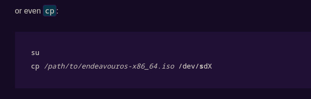

Maybe this wiki can be of any use to you ?

Doesn’t cp just copies the ISO to the usb drive ? Unless you use Ventoy that wouldn’t get you a bootable USB stick.
BTW welcome to the forum :enos_flag: :enos:
hm m m you should read your own links :wink:
but:
will not make sur eits fully written.. flash drives store data in chunks and can take up to 10 Minutes to fully sync data after copy it.. the command to make sureits synced would by sync after it frees the promplt its surely all written or watch it live: watch -d grep -e Dirty: -e Writeback: /proc/meminfo
