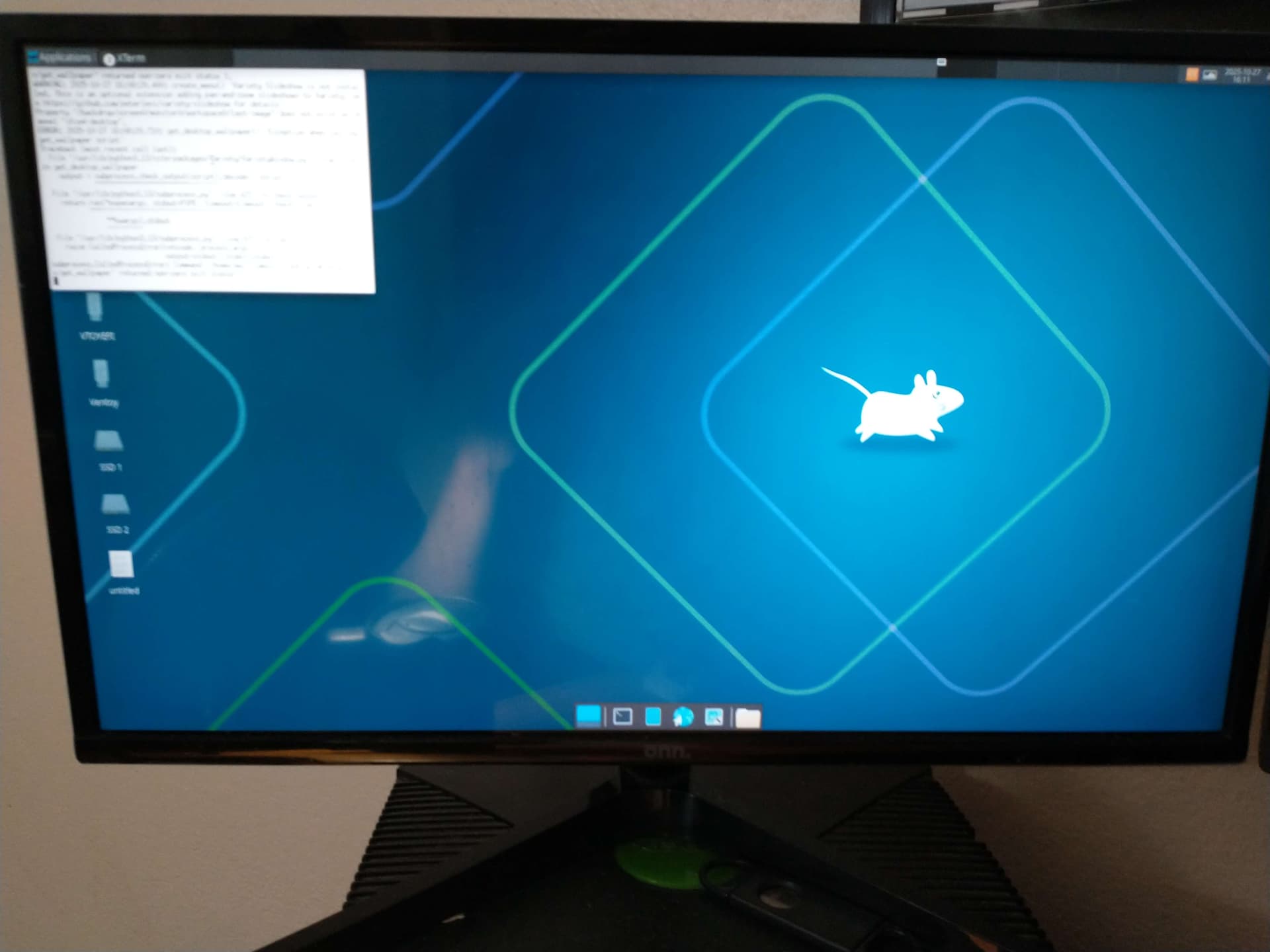

In the meantime, I have made a breakthrough in this problem:
  1. I logged into a TTY terminal
  2. I did xinit /usr/bin/xterm – :0, which brought up a black screen with a white terminal
  3. From that white terminal I did startxfce4 - which created an unthemed xfce4
    So… I don’t know what that means :confused:
The core of the issue still remains - I can’t get past the login screen, and using an unthemed XFCE4 launched via xterm isn’t really a good workaround for me lol.

So I put that back and rebooted, and now I am seeing a new error (at last) and it seems to be a very positive sign:
Whenever I do xterm and/or startxfce4 - I see it complain that Display 0 is already in use. Hell, in order to even get the xterm command to work I had to stop the lightdm service(but something still is using it?)
Whatever the case, it gave me my theme back at least, but I still cannot get lightdm to get me into the session.
Everything else seems to be in order though at least, which is a sigh of relief, and I can at least WORK now, which is very nice.
So even though the problem is still there this is a much better leg-up, thank you lmao.
