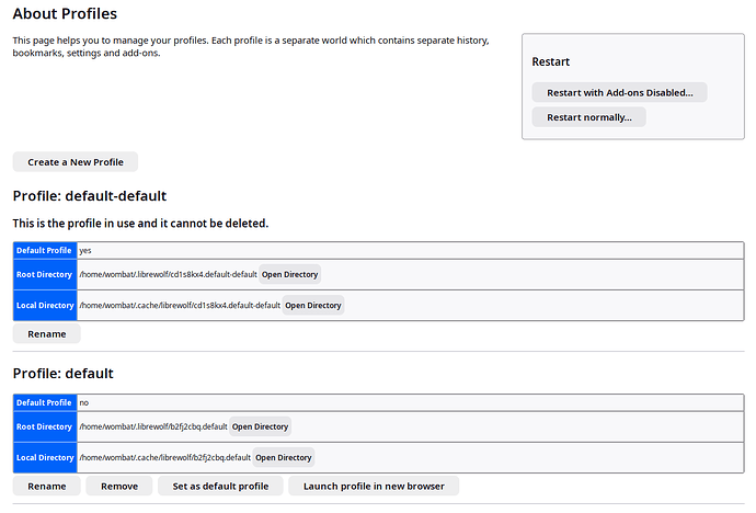

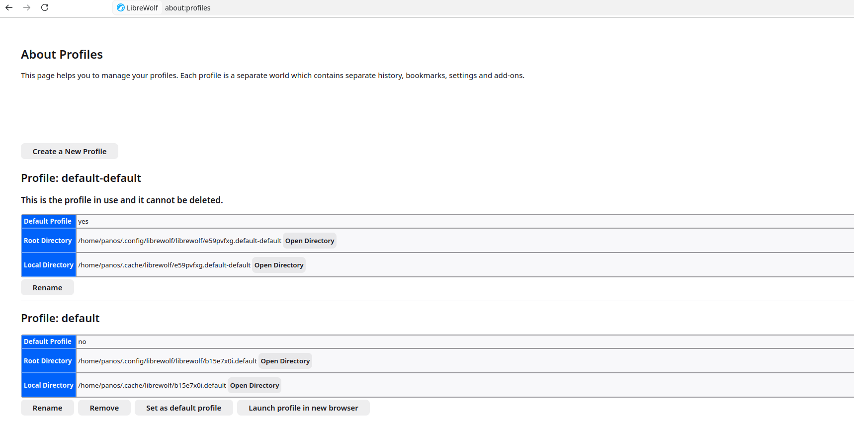

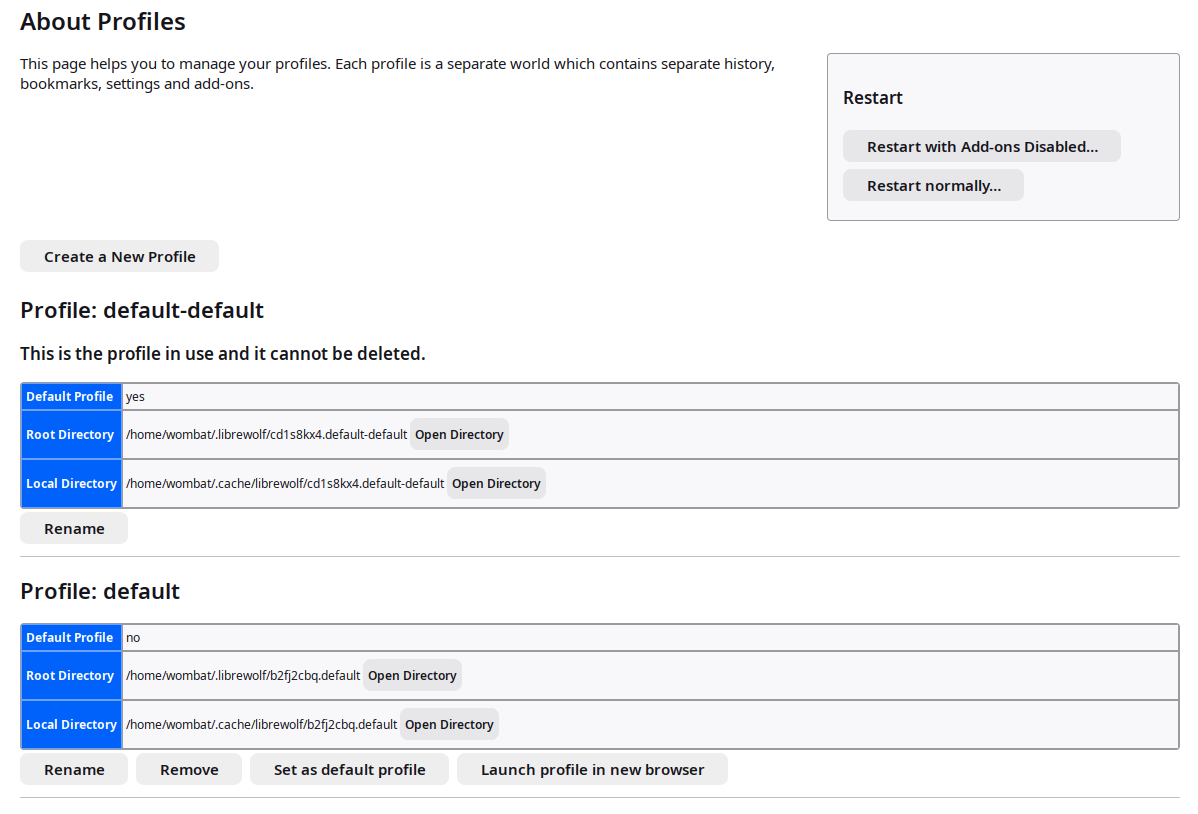

Weird, what you got in about:profiles ?
He has yes but using the welcome app. He should use what @UncleSpellbinder suggested as we don’t know what he specified in relector-simple which I assume he used.
