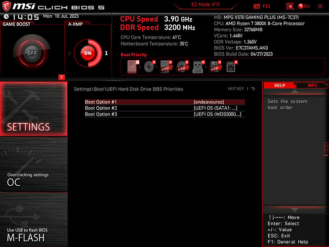

Usually when it reports this you need to select the proper boot drive from bios settings.
sudo grub-install --target=x86_64-efi --efi-directory=/boot/efi --bootloader-id=endeavouros
But got greeted by the same error about shim_lock.

Set the boot drive to the one that say’s endeavouros.
Edit: It changes the entry in nvram and isn’t booting from the proper path.

Edit: But this is what i meant. It changes the entry. Before it was listed as the UEFIOS and drive name.

I only use grub and I’m only pointing out the fact that this command is going to give you what i showed with the image. So it has to boot from that.
Edit: At least that’s how it works on my board. :wink:
