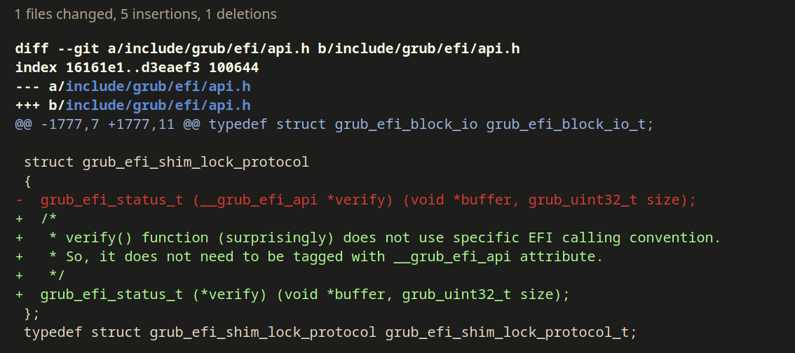

https://git.savannah.gnu.org/cgit/grub.git/commit/?id=7082a5ca8abd79c1e8840c59759f53c4c80e286d
this one mentions shim lock

efi: Drop __grub_efi_api attribute from shim_lock->verify() function
... because (surprisingly) it does not use specific EFI calling convention...
Fixes: 6a080b9cd (efi: Add calling convention annotation to all prototypes)
Signed-off-by: Daniel Kiper <daniel.kiper@oracle.com>
Reviewed-by: Ard Biesheuvel <ardb@kernel.org>
looks like this could have caused it?
It may be a combination of commits.
