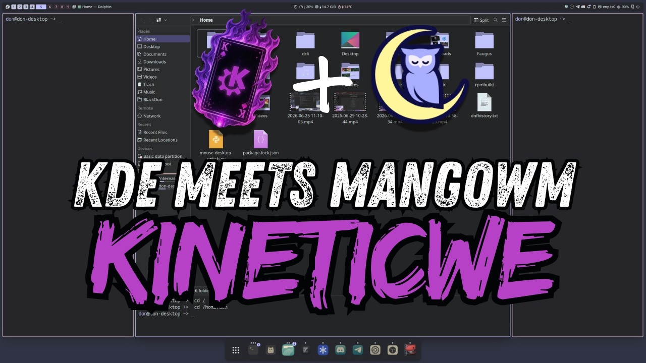

Looks like the Blackdon put his setup on the AUR:
This is the video of using KDE + Noctalia:
Pretty much in a couple months I will check it out.
