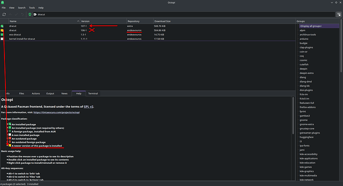

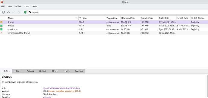

This is strange. On my system there are two dracut versions installed. Please see the attached screenshot for more details. One is 106-1 and the other is 107-1.
I doubt they are both installed. That seems to be a display issue with Octopi.
Run pacman -Q dracut, I suspect you will only see it installed once.
Yellow = indicator of package that newer version is installed of the same package
Green = actually installed version
You have enabled the Installed date column, when it’s empty, that means it’s not installed.
But as dalto also mentioned, you can clarify this to yourself via yay -Q dracut or you can further inspect it via yay -Qi dracut or yay -Qii dracut and you’ll see identical fields there also (version, install date, build date etc all good stuff..)

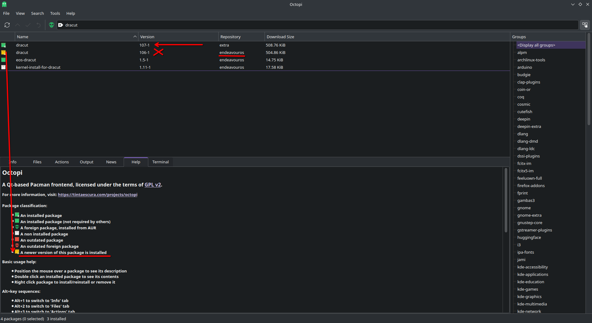

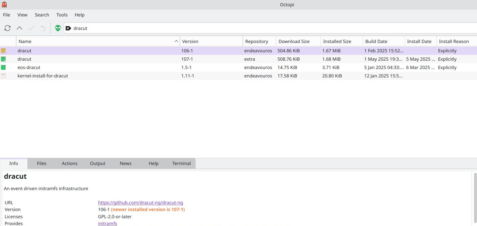

Green = actually installed versionYou have enabled the
Installed datecolumn, when it’s empty, that means it’s not installed.
But as dalto also mentioned, you can clarify this to yourself viayay -Q dracutor you can further inspect it viayay -Qi dracutoryay -Qii dracutand you’ll see identical fields there also (version, install date, build date etc all good stuff..)
Yep. dracut 106-1 is not shown when I run the command pacman -Q dracut or yay -Q dracut. And running the latest LTS kernel, i.e. 6.12.28-1-lts, does not seem to result in the error, “failed to mount /sysroot”
