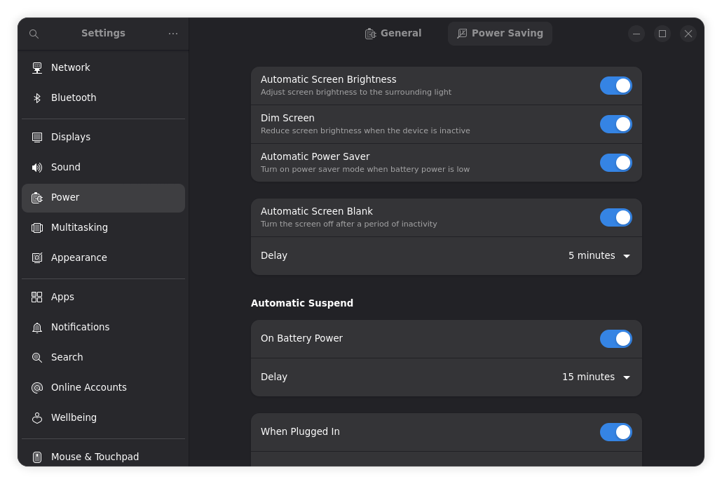

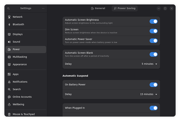

I had to re-install (EndeavourOS Ganymede + Gnome) my MacBookAir6,2 (2014) after changing the harddrive 1 month ago. I ran into two issues after the install:
The macbook appears to not automatically be adjusting the lcd backlight anymore.
Can adjust brightness through keyboard keys and Gnome Brightness sliders.
Facetimehd drivers appear to cause kernel crashes .
After installing the facetimehd-dkms and facetimehd-data packages I noticed I would often get a kernel crash on reboot after initramfs was re-built. After removing facetimehd the kernel crashes have stopped. I did test with the Arch, LTS and my daily driver 6.18.9-zen1-2-zen arch kernels.
I happen to go into OBS and noticed that it could access the Apple Camera without the AUR Facetimehd drivers.
Question:
Do we no longer need to use the facetimehd drivers?
Anyone light backlight sensor working with macbook airs?
