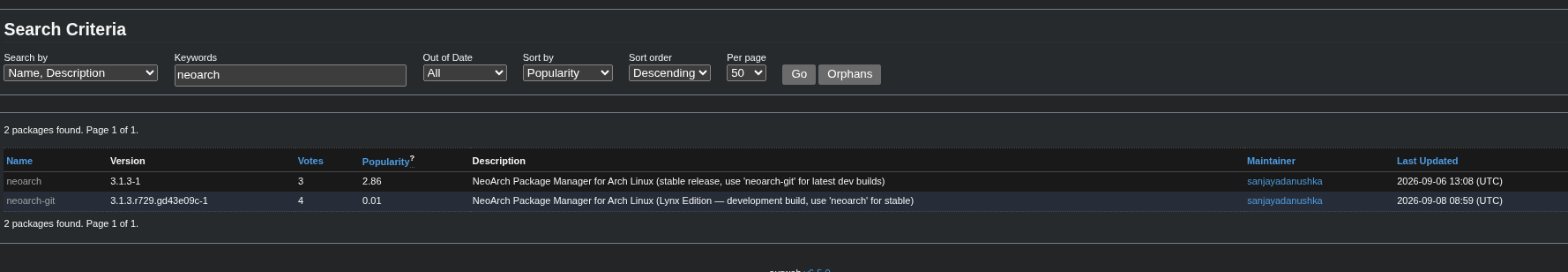

Actually, AUR already has neoarch-git. -git is for beta/development releases, while neoarch is for stable releases.

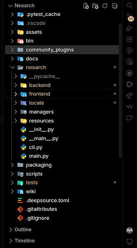

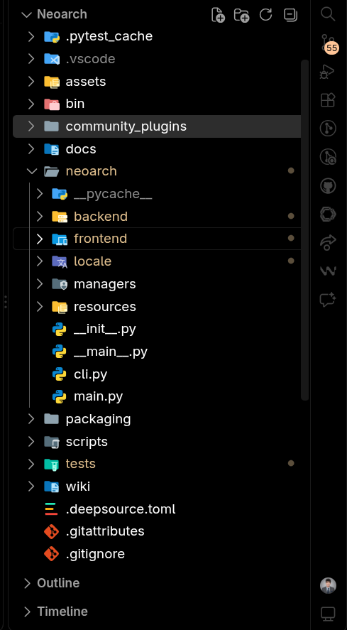

think this easy “change this part”? actually behind scene its not easy need to check codebase and sub modules and this app i divide as front end and backend as for easy need to think deep hard to change. No contributors, no pull requests, and no one helping with testing so far. So yeah, this isn’t easy to maintain alone. I’m doing the development, testing, bug fixing, and improvements myself alongside my daily job.

i post screenshot ,Don’t be fooled just because someone says, “The app is good, download it.” If the project is open source, you can check the code yourself and see what the developer is actually doing.

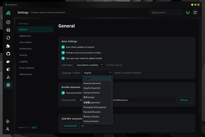

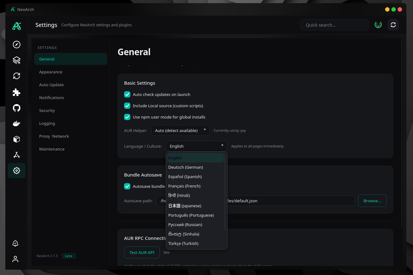

And I’m happy to say that NeoArch is still growing. Just last night I added support for 10 languages:
:united_kingdom: English, :spain: Spanish, :sri_lanka: Sinhala, :india: Hindi, :germany: German, :france: French, :portugal: Portuguese, :china: Simplified Chinese, :russia: Russian, :türkiye: Turkish, and :japan: Japanese.
All of them are fully translated now, and I’ll keep adding and improving things day by day.
So thanks to everyone who has tested NeoArch, reported issues, suggested improvements, or even criticized it in a useful way. I’m still learning, and every good suggestion helps me make it better. :heart:and future updates im add endeavouros theme for my app.finally thanks all very much
