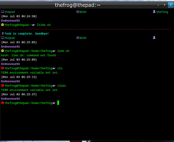

If I type a script name and execute it it runs but if I rerun the script I get the command is not found error like something happens to my path variable? I have /home/thefrog/bin as part of the path variable and export it through .bashrc as I have for years. I’m not going to downgrade as long as I can as to see what other issues may be creeping up from this kernel.
this is interesting
seems like its environment variables are being wiped after the initial command
new pic with no typing errors lol
