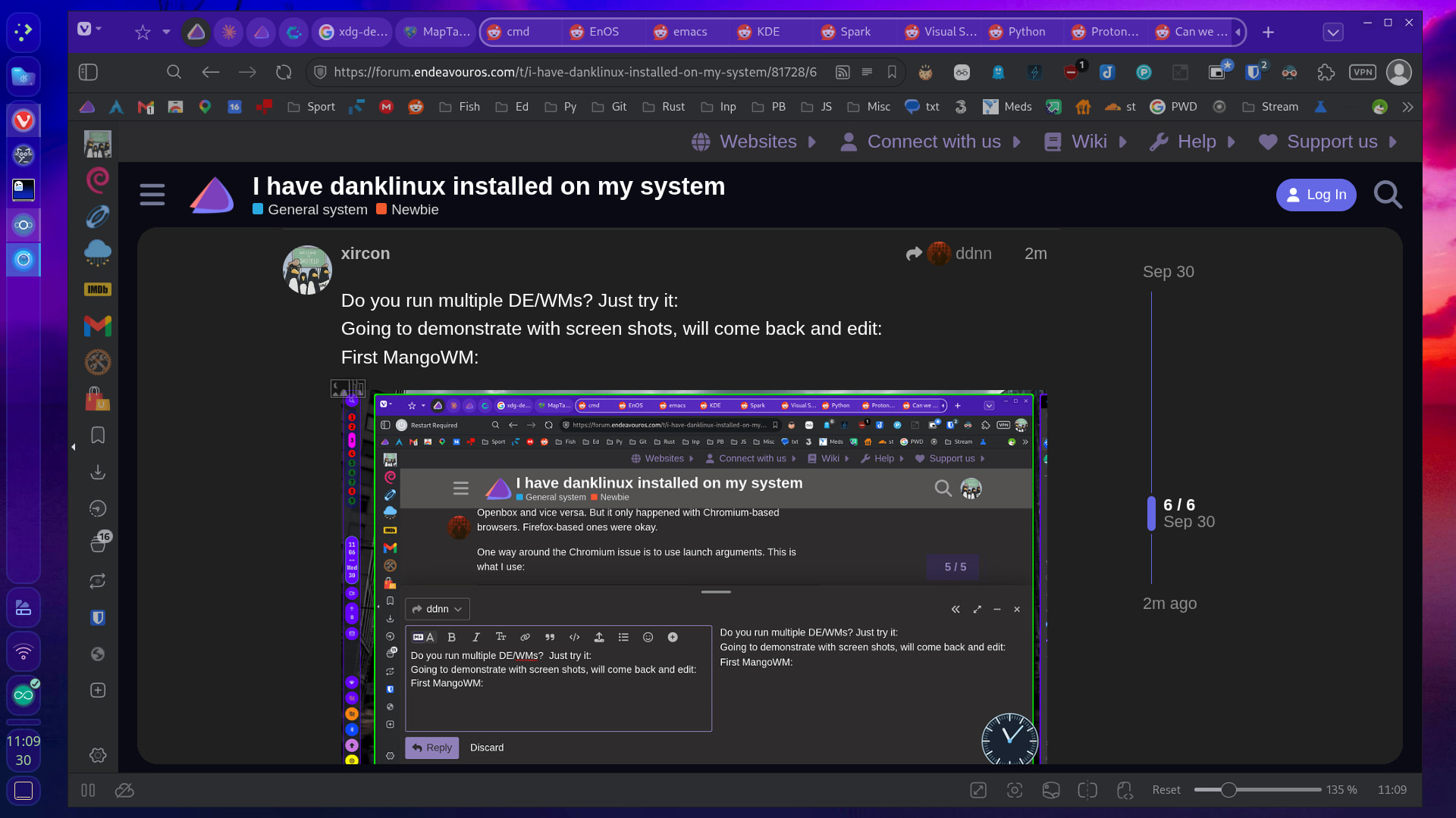

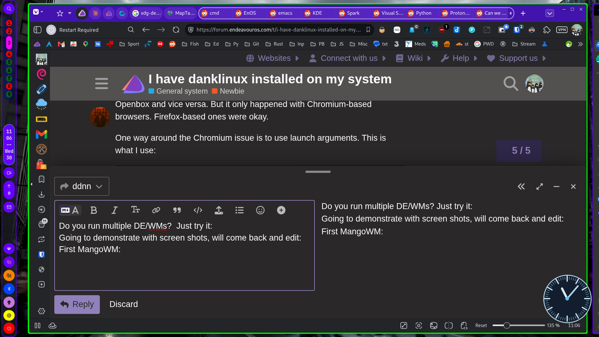

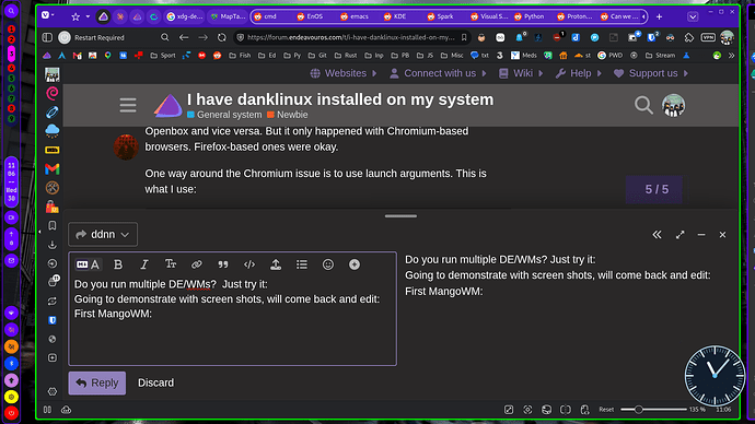

Do you run multiple DE/WMs? Just try it:
Going to demonstrate with screen shots, will come back and edit:
First MangoWM:
Next Plasma (BRB)

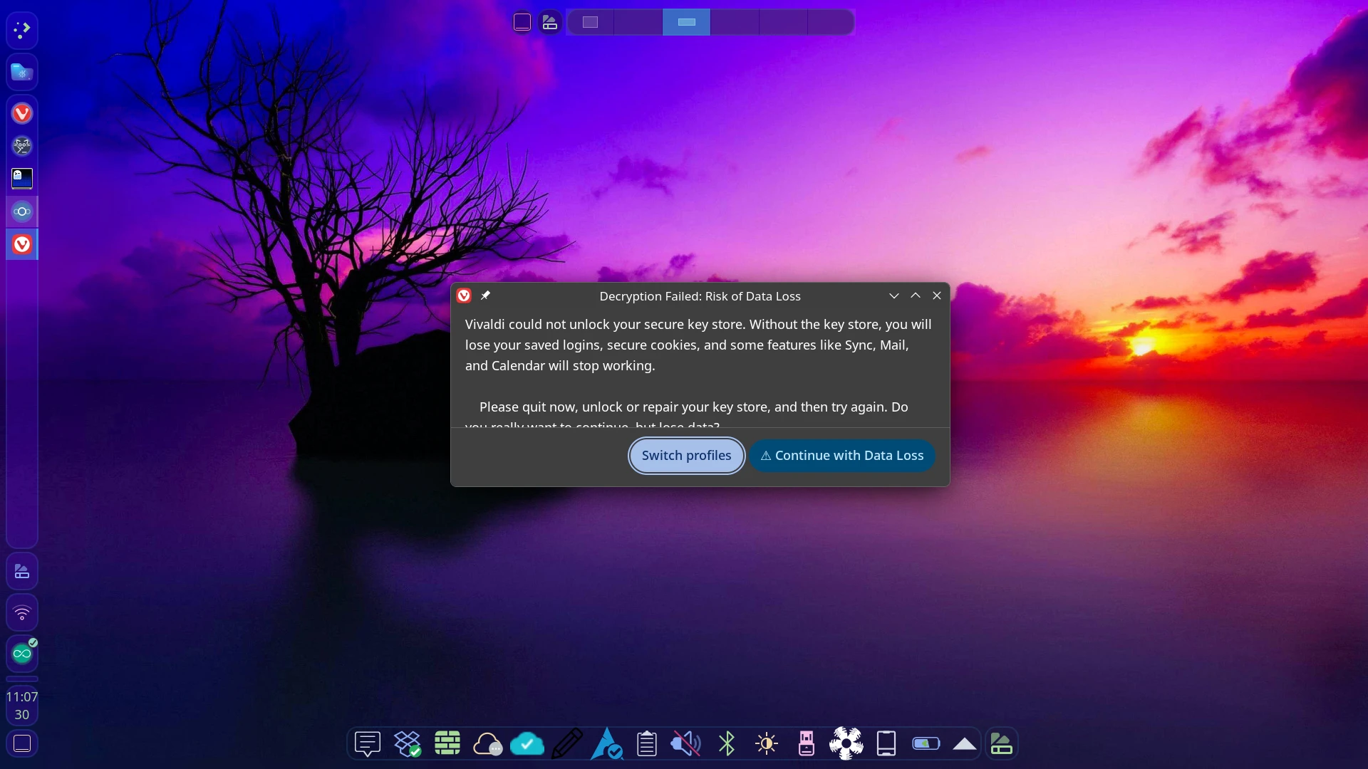

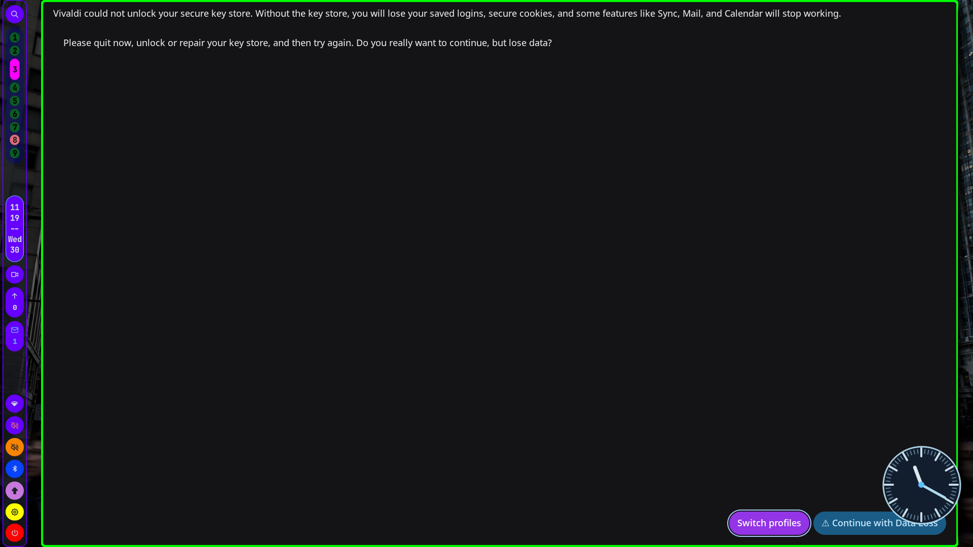

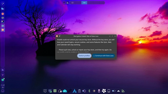

Image 1 - logged in to forum, logged out to plasma.
Image 2 - Always get this, clicked continue with data loss
Image 3 - Logged out of forum…
Am running kwallet, tried gnome-keyring and recently tried oo7 - same issues. Cannot find the article I read that said the desktop portal switch was the issue.
