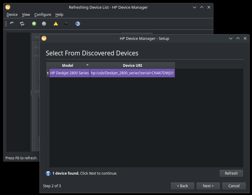

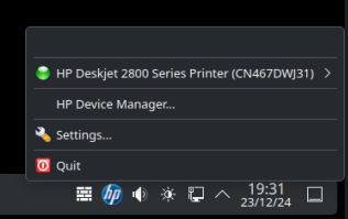

Hi friends. I couldn’t get my Canon printer to work on EOS and had to return it and buy this HP Deskjet 2800e. I installed it, turned it on, calibrated it and connected it to the PC via the USB cable. For some reason it doesn’t detect it, I’m really desperate, I don’t know what I’m doing wrong.

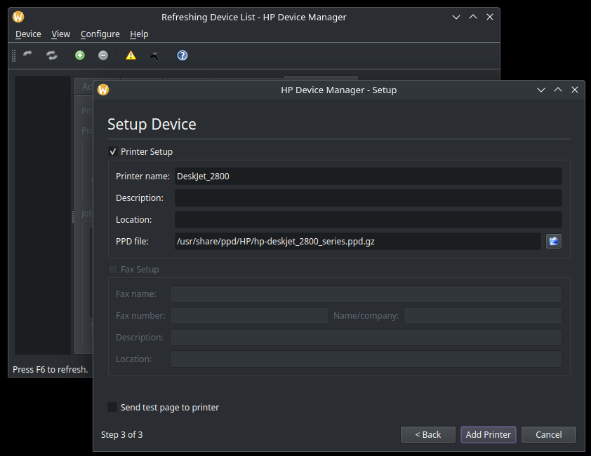

Try installing hplip and then running “HP Device Manager”

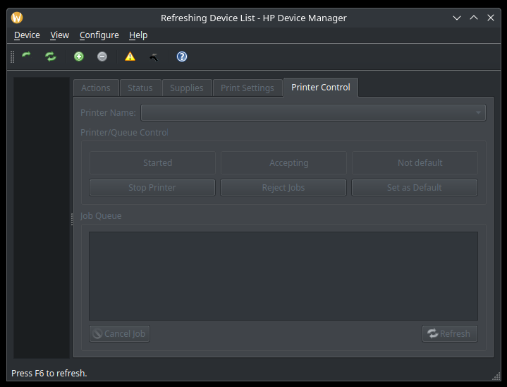

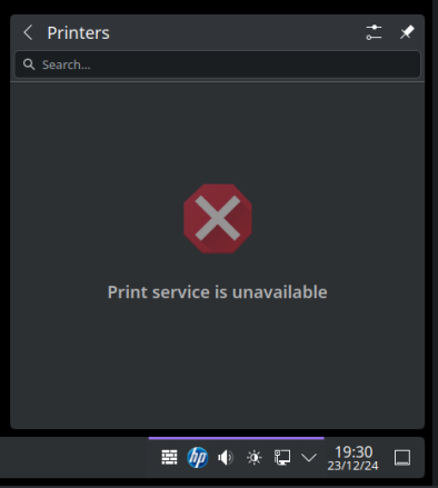

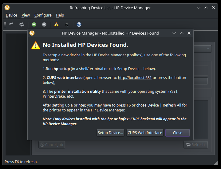

Thank you very much Dalto, it seems that the printer has been detected, but I cannot print. It is on, with paper, I open a png file, press ctrl+p, but it says create a pdf, not print, and restarting EOS did not work either.
Not sure if this helps using hp lip
Thanks, I found this too. It seems the words in red are missing libraries?

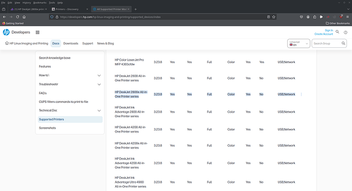

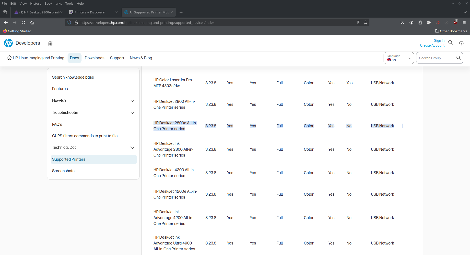

Usually hp printers are pretty easy to get working. I don’t really have much experience with them as I don’t have any hp printers.
From the wiki page: hp lip supports that printer
https://discovery.endeavouros.com/network/printers/2021/03/
