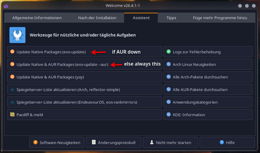

in my opinion this is the best way to update. it NEVER failed me so far. either press that button or type the command (…pressing the button is faster for me bc i am so slow at writing :rofl: though i could also just autocomplete it, but… habit, since it always pops up i can just hit it if i feel like it)
