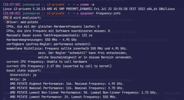

Looks like it is working also on my desktop Ryzen 3800X
[ricklinux@rick-ms7c37 ~]$ cpupower frequency-info
analyzing CPU 0:
  driver: amd-pstate
  CPUs which run at the same hardware frequency: 0
  CPUs which need to have their frequency coordinated by software: 0
  maximum transition latency: 131 us
  hardware limits: 550 MHz - 4.56 GHz
  available cpufreq governors: performance schedutil
  current policy: frequency should be within 550 MHz and 4.56 GHz.
                  The governor "schedutil" may decide which speed to use
                  within this range.
  current CPU frequency: Unable to call hardware
  current CPU frequency: 571 MHz (asserted by call to kernel)
  boost state support:
    Supported: yes
    Active: yes
    AMD PSTATE Highest Performance: 166. Maximum Frequency: 4.56 GHz.
    AMD PSTATE Nominal Performance: 142. Nominal Frequency: 3.90 GHz.
    AMD PSTATE Lowest Non-linear Performance: 64. Lowest Non-linear Frequency: 1.76 GHz.
    AMD PSTATE Lowest Performance: 21. Lowest Frequency: 550 MHz.

it is fixed here
$ cat /sys/devices/system/cpu/cpu0/cpufreq/scaling_driver
amd-pstate
$ uname -a
Linux eos 5.18.13-arch1-1 #1 SMP PREEMPT_DYNAMIC Fri, 22 Jul 2022 13:05:04 +0000 x86_64 GNU/Linux
