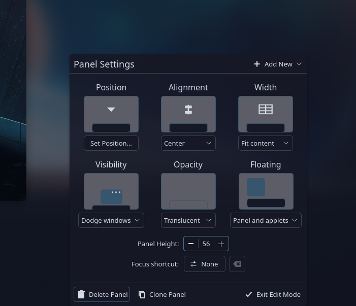

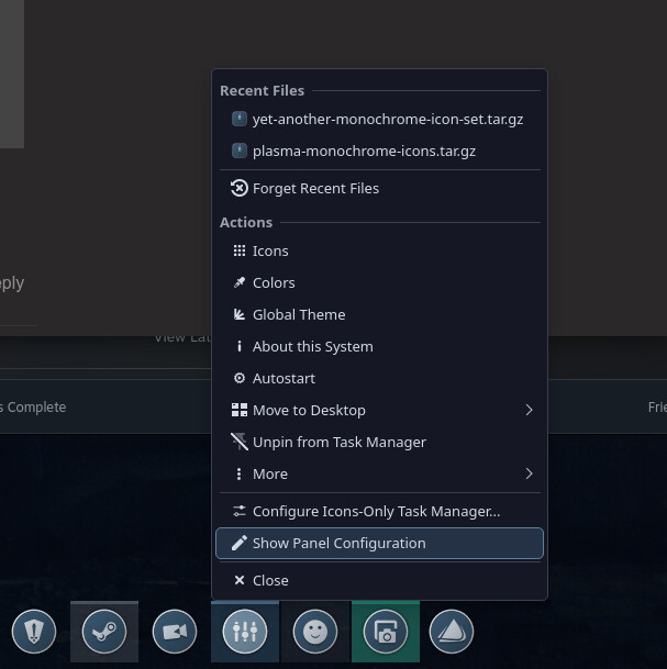

Select the panel you want to delete by clicking on it with right side mouse button > Select Show Panel Configuration >
This really sucks. . . . I don’t have the ‘delete panel’ ‘close panel’ ‘or exit edit mode’ at the bottom
of the screen. . .
Rich :wink:
Did you click on top of the panel with the right mouse button and select “Show Panel Configuration”?
I some how have the widgets running on another panel and I can’t close that panel or edit and remove it. . . on top of that I’m messing up my original panel in the process. . .
