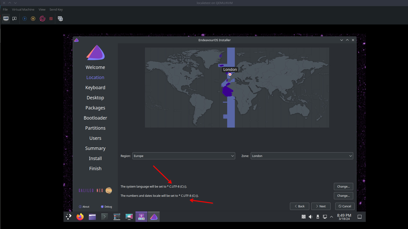

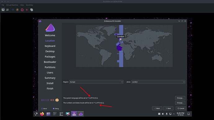

For testing purposes, I have created a VM with i3. I can confirm that I was able to install with C.UTF-8 selected for LANG and locale and it stayed after reboot.
What I had suggested in a previous post, was upon setting LANG, everything else then defaults to the en_US.UTF-8 for all (or whatever other LANG had been set), which is what I had thought that C was supposed to do.
I have now reset it all back to C and rebooted without problems.
I did all of the above using localectl
followed with sudo locale-gen
without any problems. Both locale
and localectl
output the same results. I tried several other LANG settings as well (after uncommenting them in /etc/locale.gen
and the result is the same. All locale settings default to the new language setting.
Edit: In other words, I cannot get LANG set to US and everything else set to C. Itās either, or, not both and.

Above all, I donāt believe that this can be selected during installation!
You donāt believe what can be selected during installation? If you are referring to C, it can beā¦
And with C set, simply running sudo localectl set-locale LANG=en_US.UTF-8
then running sudo locale-gen
sets everything to US. Returning LANG to C, also does the reverse. Iāve tested it multiple times in a VM today.
The other user explained in a post above why they want it set to C.
I do agree, localectl is easier, but editing the config file does work.
