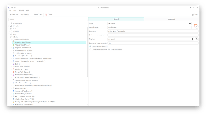

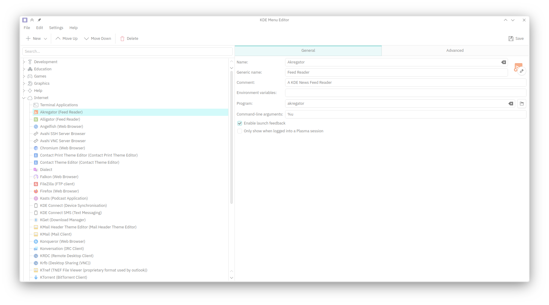

sorry I’m having a hard time understanding the GUI, the alternative solution you suggested isn’t quite clear.
Choose your folder, richt click on it and select Add New.
Name is the name as it appears in the menu
Generic Name describes what the program is
Comment and Environment variables can be left blank usually
Program is the name of the program that you want to run. You can navigate to it using the little icon to the right.
Command line arguments, you might not need. If you do they’ll be specific to the program.
Launch feedback enables the bouncy cursor.
You choos the icon for the entry by clicking on the little box next to the names.
When done click Save.

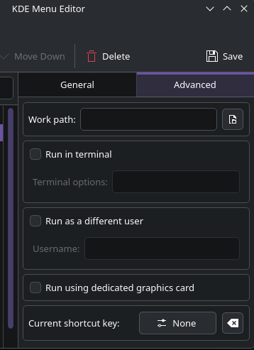

Can you also explain a little what’s this work path field?
That’s the current path when the program runs. It will default to the program directory, but can be changed if needed.
