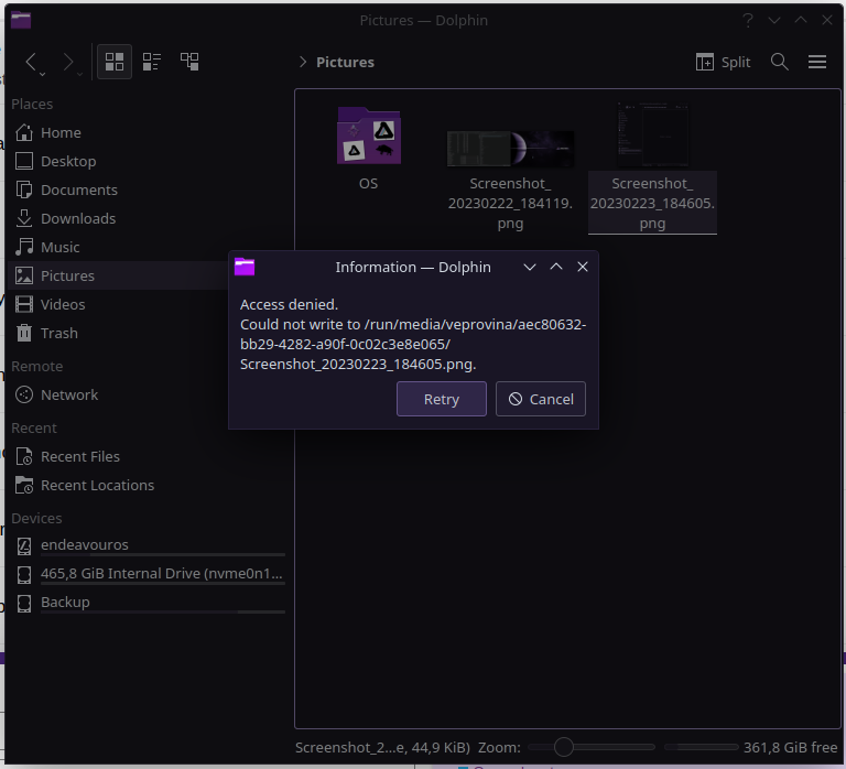

It’s recognized in Dolphin as a disk, i formatted it to btrfs like the others, and mounted it to /home/user/Data - all in partition manager.
But if i drag a file to the disk directly, it says it can’t write to it, access denied, and the “Data” folder i created seems to just be on the nvme that has the OS on it…

Hmm, did that, created a folder, chowned it, then with partition manager mounted the drive to that folder, still access denied…

EDIT: Yeah, i can make a folder in terminal, but can’t copy anything into it from Dolphin, just from terminal. It’s something about ownership it seems. Root owns it but my user doesn’t.
