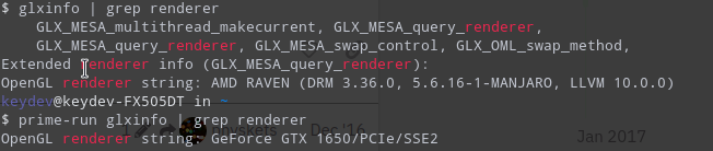

This is an image of how it worked on Manjaro with the driver I mentioned in the first post.
Edit: I was offloading applications to the nvidia GPU by using prime-run. Else they were run on the AMD IGP. I’d like to replicate that if possible.

ferretwithaberet@ferret-FX505DT in ~
$ glxinfo | grep renderer
    GLX_MESA_query_renderer, GLX_MESA_swap_control, GLX_OML_swap_method,
    GLX_INTEL_swap_event, GLX_MESA_copy_sub_buffer, GLX_MESA_query_renderer,
Extended renderer info (GLX_MESA_query_renderer):
OpenGL renderer string: AMD Radeon(TM) Vega 8 Graphics (RAVEN, DRM 3.40.0, 5.10.7-arch1-1, LLVM 11.0.1)
$ prime-run glxinfo | grep renderer
OpenGL renderer string: GeForce GTX 1650/PCIe/SSE2
Seems to be working now, I just rebooted after deleting the configs in /etc/X11/xorg.conf.d/ and it seems to work, maybe I had to reboot after installing nvidia-prime to be able to use it. Thank you for the assistance anyway!
Yes!!! :+1:
@ferretwithaberet
It looks like you have it working now as you had. It shows both devices with the proper drivers installed so i think you have replicated what you had been doing previously. Great job!
