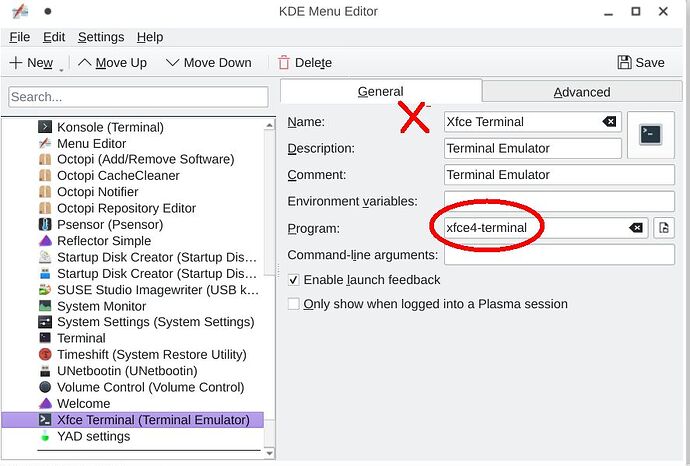

$ gsettings set org.cinnamon.desktop.default-applications.terminal exec Xfce4 terminal
Usage:
gsettings [–schemadir SCHEMADIR] set SCHEMA[:PATH] KEY VALUE
Set the value of KEY to VALUE
Arguments:
SCHEMADIR A directory to search for additional schemas
SCHEMA The name of the schema
PATH The path, for relocatable schemas
KEY The key within the schema
VALUE The value to set

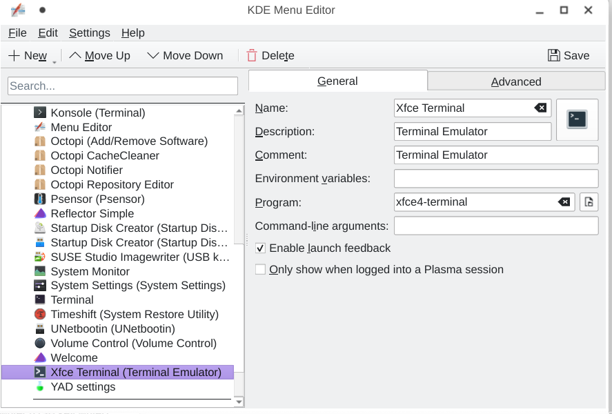

Xfce Terminal is wrong. You’ll need to see what the actual application name is. Right click on the menu button and select Edit Applications. Navigate to the Xfce terminal and select it. You will see the application name in the program field.
Ok got it now Richard…Thanks!
$ gsettings set org.cinnamon.desktop.default-applications.terminal exec xfce4-terminal
